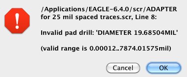

    I am blundering through the learning process.  I have now found enough information to run this script.......
    # Allowed units are mm, mic, mil and in
    GRID MIL ;
    # Wire  width end1  end2
    WIRE 8mil ( 0mil 0mil ) (0mil 1000mil);
    WIRE 8mil ( 25 0 ) ( 25 1000 );
    change drill diameter 19.68504mil;
    via 'test_name'( 0mil  0mil ) 70 octagon  1-16 ;
    via 'test_name'( 25mil  100mil ) 70 octagon  1-16 ;
    via 'test_name'( 50mil  200mil ) 70 octagon  1-16 ;
    via 'test_name'( 75mil  300mil ) 70 octagon  1-16 ;
    I am faking the comments using the # sign.
    I get an error when I try to change the drill diameter.......
    What is an acceptable diameter ?  Do I have to set these in some kind of preferences ?

    Update   I discovered some scripting changes that worked.......
    GRID MIL ;
    # Wire  width end1  end2 ;
    layer top ;
    WIRE 8mil ( 0mil 0mil ) (0mil 500mil) ;
    WIRE 8mil ( 25 100 ) ( 25 500 ) ;
    WIRE 8mil ( 50 200 ) ( 50 500 ) ;
    WIRE 8mil ( 75 300 ) ( 75 500 ) ;
    change drill 10mil ;
    change diameter 10mil ;
    change shape octagon ;
    via 'test_name'( 0mil  0mil )  ;
    via 'test_name'( 25mil  100mil )     ;
    via 'test_name'( 50mil  200mil )     ;
    via 'test_name'( 75mil  300mil )  ;
