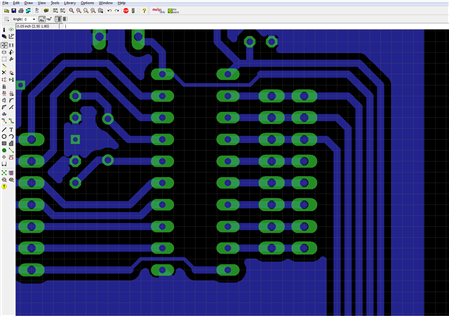

Hi,
Is there any quick way (or any way) to remove routes (copper) from inside of pads? I have something like this:
And I want to have empty holes inside of pads after exporting to image. How to do it? image

    Hi Marek,
    I think, this is answered in a thread 16.8.2013 19:47 (Kevin Farrows).
    For the homebrew Printed Circuit Boards, use drill-aid.ulp. I used it
    also a long time ago and just tested, and it works.
      Asko.
