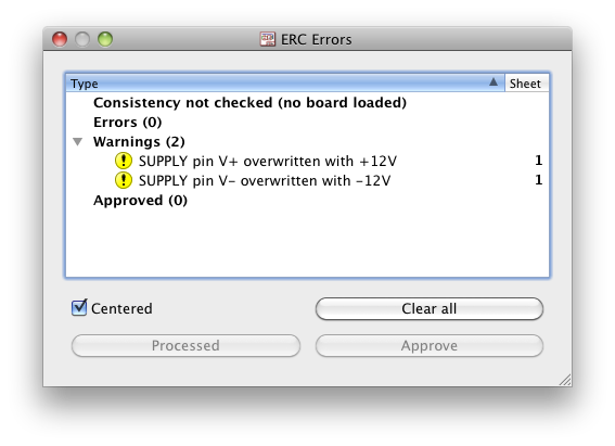

    Finally, I got some ERC errors which I don't understand:
    These are the power pins of the two ICs. I've chosen +12V, -12V and 0V from "Supply2", then attached them to the different parts of the schematic needing power. So why am I getting those errors?

    All the +12V connections will automatically connect to each other assumimg that the wires have the same name (ie. you can assign a name to a net, and then that means they are connected, even if the schematic doesn't have a wire drawn from one place to another).
    So, just to confirm all is ok, click on the 'info' button in EAGLE, or the 'name' icon, and then go around and click on a few wires where you expect to see +12V or -12V or 0V. You should see a net name, it doesn't matter what the name is, but it should be the same for all points that you want at the same voltage. When you look at the PCB view, you'll see yellow airwaves connecting those points too. If this is fine then you can safely ignore the warnings (or 'accept' them).

    I can't figure out the power supply issue because "invoke" really doesn't help.The two PSU pins are shown, but I can't check their values with either "Name" or "Info" unless I add a small wire first. Still I only get names like N$9.
    Is there a way to add a "label" to pins like that, just for the sake of the schematic (i.e. no actual component, but just a symbol which attaches like a component)?
    Shabaz: from your understanding the names of the power supply outputs should match the names of the power pins of the ICs, so I changed the + and - supply from one of the "supply" libraries (so instead of "+12V" and "-12V" I now have "V+" and "V-" which removed some of the error messages.
    However I do have these error messages:
    I believe it's asking if I should join together the +V with the lines I renamed +12V (it was previously named something like N$12 or similar IIRC) and -V from the PSU to the lines I renamed -12V. How do I solve this issue? By selecting one of the two lines with the yellow "!" symbol and pressing "Processed" or "Approve"?
