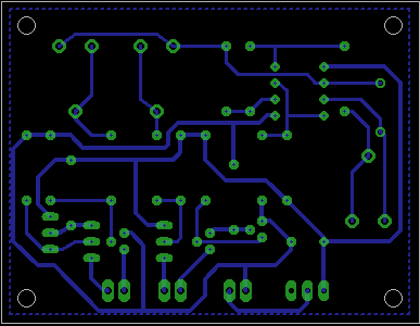

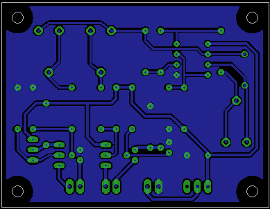

    If you want grounding a signal layer, this can be make by drawing a
    polygon around the board an then use "NAME" to connect to GND-Signal.
    Then click the button "Ratsnest" so then all signal wires will be
    isolate into the GND-polygon. e.g. isolate > 0,5mm, or so -> voltage!
    This looks like this:
    After them, if you have to do something, you can do, but you have to click the button "Ratsnest".
    Then the polygon redraw.  Unroute (hide) the polygon by click on the polygon and then click
    the button "Ripup". Redraw  again -> "Ratsnest".
