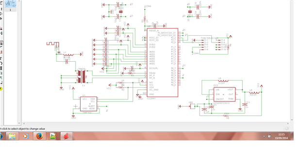

Hello all,
I am doing a project where I have to design a PCB. I am new in this field. I am using EAGLE PCB software.
About my project: I am working on a project where I have to measure the environments temperature. I am using TI's CC2541 Bluetooth soc, temp sensor TMP102, DC DC convertor, SOC debug flash TSW-105-02-S-Q and MURATA's Balun transformer. Whenever I put the battery in my PCB, the temp sensor reads the data and send it to my phone via Bluetooth. For this PCB design I am using eagle software. Since I am new to this software and I am working alone in this project I want help from you all.
Till now I have the schematic design on software. I am attaching my pdf file here, so you guys check the file and tell me if I am going in a right direction or not?
And also how to check the design if it is correct or not? I clicked on the error button, it is showing warnings only not an error.image
Guys please help me with this.

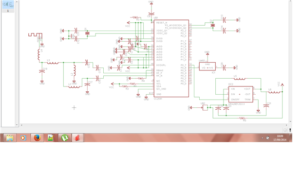

  • Former Member
    hey guys I am really very sorry I posted the wrong schematic.....the correct is this...
    sorry fro the wrong one...this is the correct one
  • michaelkellett
    michaelkellett over 11 years ago in reply to Former Member
    Are you following the TI reference design EXACTLY - it is very ambitious to try and do an RF pcb as your first project and unless you have access to expensive RF test equipment you will not get it to work unless you copy the precise track layout of the reference design and use exactly the same components.
    If I were you I would consider using  a ready made Bluetooth module with the RF section already built and tested.
    MK
  • Former Member
    Former Member over 11 years ago in reply to michaelkellett
    yes I am using TI's reference design. I am working on a Bluetooth PCB not an RF PCB. I am making it simple by using just CC2541 chip and a temp sensor.
    Is something wrong what I am doing..?
  • michaelkellett
    Designing board for RF is very difficult and I get the impression that you have very little experience. Google "rf pcb design" and read this link as well:
    "www.ti.com/lit/an/swra367a/swra367a.pdf"
    If you copy  a proven design exactly it may work but differences in pcb material and manufacture may still cause problems.
    MK

  • Former Member
    thanks for you reply.....
    the link you gave is not working...
    I have no experience, first time I am doing a PCB project and I am alone, that's why I am bit concern about if am doing it right or wrong.
    I will read about rf pcb design....but I am working on Bluetooth not on RF that's why I chose the CC2541 Bluetooth chip. there is no mention for rf pcb design....
  • michaelkellett
    The link works for me  if you take the quotation marks off - I had to put them in because E14 whinged, if it wont work for you then search for swra367a on TI's website.
    Bluetooth = Radio
    RF = Radio Frequency
    If you read ALL the TI material (data sheets, app notes etc) about the CC2541 you will find a lot of discussion about the pcb design and the issues with aerial matching.
    MK
  • dukepro
    dukepro over 11 years ago in reply to Former Member
    rf pcb design....
    Look on page 24 of the CC2541 datasheet, paying particular attention to
    the components attached to pins 25 and 26.  Those caps and inductors and
    antenna ARE an RF design.
    Bluetooth operates in the 2.4 GHz ISM band.  Even if you exactly
    duplicate the reference design, as mentioned earlier, you will probably
    still have trouble due to differences in PCB material and thickness.
    I would reiterate the earlier suggestion of using a pre-made Bluetooth
    module, and connect it to your microcontroller with SPI, I2C, TWI, or
    the like.

  • Former Member
    I Google about RF PCB design and I got some material.....
    So, whats your view about my PCB design....like its hard to make or in future I will have some difficulty about it..??
