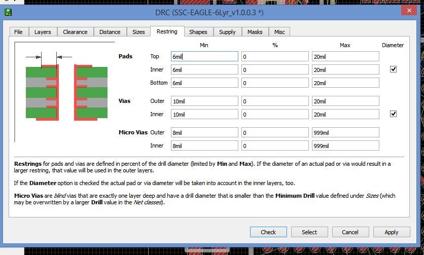

I am currently routing a project and have run into an issue. I have set my drill hole to 6 mil and diameter to 10 mil as well as adjust the restring to 10 mil 0% inner and outer. However, once the via is created it creats as an inner and outer diameter of 26 mil. How do I stop this from happening? This hinders my project as it prevents me from routing the BGA chip.

    Would have helped if you posted a screen shot of your DRC > Restring
    settings.
    I'm guessing you have 10mil set for the minimum hence you get 10 + 6 +
    10 = 26
    If so make the minimum 0 along with 0%
    Your drill hole of 6 mil and diameter of 10 mil will give a restring of
    2mil which is small. Check with your board house what their minimums
    are. Once you know that you can set the restring minimum to that and
    have the DRC assist by creating restrings of that size, ensuring you
    don't go below that figure
    HTH Warren

    Sorry, attached is picture of my DRC. I will try what you have stated now. How does the calculation occur that would turn my minimum into much larger?

    Its a two step deduction.
    First the drill diameter is taken and the specified percentage of that
    is used to reach an intermediate figure. With 0% that result is zero. so
    the hole at this point has no surrounding copper.
    Then, depending on whether you have specified a diameter for the via or
    left the setting at 'auto' a result is reached.
    With 'auto' set, the intermediate result is compared with the minimum
    and maximum values set in the DRC. If smaller than minimum the value is
    increased to be the minimum value. If larger than maximum the value is
    reduced to be the value of the maximum seting.
    With a diameter specified, the same happens as above for minimum but for
    maximum the larger of the intermediate or maximum setting is used.
    Remember the rest ring is a width not a diameter. it goes around the
    hole so you get that width on both sides of the hole so the diameter of
    the via is restring width + drill diameter + restring width.
    It all in the manual and help and the image you posted
    HTH
    Warren

    Interesting, it does not work the way I expected it to work. Please correct me if I am wrong. When you set the diameter then you are actually setting the rest ring width not the the diameter of the over all PAD. This does aid in setting the DRC. I do have my DFM settings from the manufacture and will be putting these in. But if I understand correctly I will have to modify the min values to handle that it is the ring width not the diameter.

    Many have a problem accepting how this works.
    You are specifying your desired diameter but you don't get it
    unconditionally.
    Like I wrote earlier, if you don't specify a diameter and leave it as
    Auto then the design rules will calculate a restring width and that
    constrained by the max and min settings and combined with the drill size
    will result in a pad diameter.
    If you specify a diameter for your pad rather than leave it set to Auto,
    you will get that diameter if it is larger than the calculated diameter.
    If the calculation is larger you will get that diameter, not the one you
    specified.
    So for those that always want to specify their pad diameter, they should
    ensure the calculated one is always going to be smaller than what they
    specify, for all drill sizes on the board.
    HTH
    Warren
