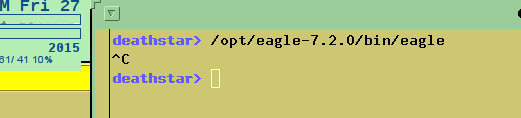

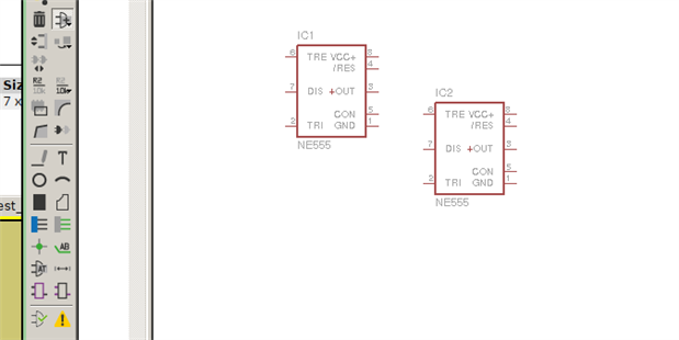

1. I click 'Add'->'Search' then select my part and place it on the schematic sheet (first Image).
2. I hit 'Esc' and the part-outline disappears but I don't get back my 'Add' dialog (second Image). Note that the 'Add' Icon is still selected, but clicking does absolutely nothing. The cursor shape is still a cross-hair.

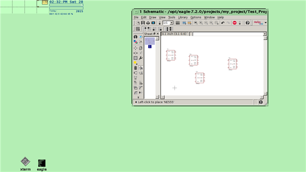

3. I have to Ctrl-C and exit Eagle completely (third image).

    Are you sure your window manager hasn't done something stupid like bring
    the add dialogue back up behind one of the other windows?

    I closed all my windows, started Xterm, started eagle (control panel), started Schematic Editor, then minimized Control Panel and Xterm and this is what it looks like after I add NE 555 and hit Esc. As you can see, none of the virtual-desktops (1,2,3,5,6,7,8) have an open window The two minimized windows show up as 2xtiny squares in virtual desktop-4. Is there a way to detect if a window if off-screen? I'll try to paste strace output..

    So the problem seems to be with bringing the hidden window back.. when you hit 'Esc' and perhaps whatever Eagle is doing to to bring back the hidden window is not enough..

    It's an ICCCM compliant WM, but it doesn't seem to support EWMH because I cannot pull that window to the front manually using 'wmctrl'. I'll test on another WM and see.
  • Former Member
    Former Member over 10 years ago in reply to Former Member
    tested and eagle works nicely on twm (which does not support EWMH) so.. as you said, probably a bug/'feature'.
