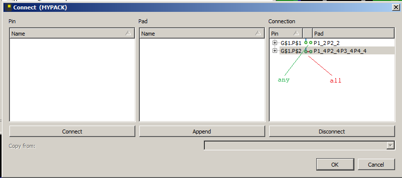

    Ok, here goes; in Device wiev/ Connect panel, I can assign several pads to a pin. Then there is the option to choose ALL or ANY, "any" being pertinent to my issue. Now I can route to any pad assigned. As will autorouter!
