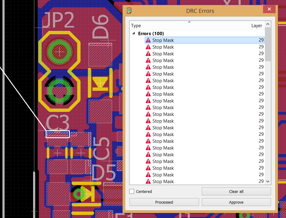

Hi
Iam Working one of the PCB, when i run the DRC, Iam getting Stop mask error, even though you have a space between Solder mask and Silkscreen, please find below image. i have highlighted Silkscreen and Stop mask. iam not sure how to set clearance between Silkscreen and solder mask in eagle, can you please suggest.

    DRC reports a Stop Mask if:
    If there are silkscreen objects drawn in layers 21, 25, 27 for
    components on the Top layer, and 22, 26, and 28 for components on
    the Bottom layer overlapping the area of a solder stop symbol
    generated in layer 29 and 30, the DRC reports a Stopmask error.
    You have to display the corresponding layers to activate this
    check! Please keep in mind that this check always takes the vector
    font as basis for the calculation of the required space. This is
    the font type the CAM Processor uses for manufacturing data generation.

    0 e14 Contributor over 10 years ago in reply to autodeskguest
    This is not resolved my issue. I have enabled all 21, 25 and 27.. there is no silkscreen objects at all. here are the images.
