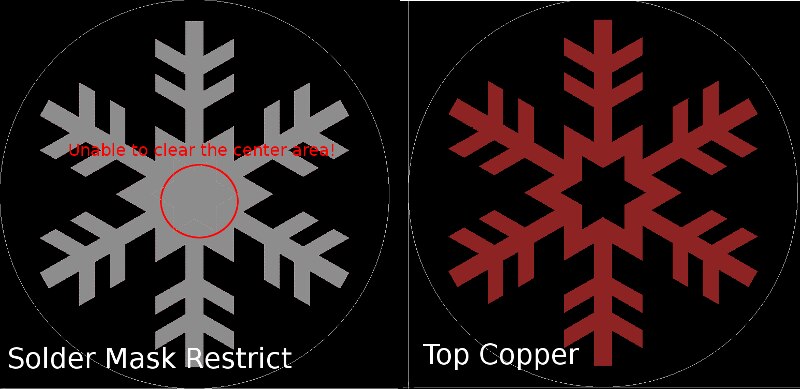

Is there any way to specify a region (sub-polygon) within a tstop polygon where there should be soldermask?
I'm designing a series of Christmas ornaments to give away as gifts. I've created a number of simple motifs (example... snowflake) within AutoCAD and then imported them as polygons into EAGLE. By using multiple layered polygons and specifying cutout fills on a few of them I can successfully create the desired images within the copper layer. The issue is that I was wanting to have this copper exposed for gold surface plating and I am unable to get the proper effect with the soldermask restrict layers. Currently I am only able to make polygons on the tstop layer that remove soldermask, I am unable to make any sort of "cutout" regions where there should be soldermask, for example in the center of a snowflake. I'm not willing to leave these regions exposed since there won't be any copper there and the bare FR4 will be showing. (ugly...)
Likewise I can't simply leave the entire top layer of the board a copper pour and put the image in the tstop layer since the same issue with internal areas will still be there. (I would only be able to do an external outline of the motif...) Not to mention I will be placing numerous 0402 LED's around on the ornament, and the clearance between the pads and pour would make them more visible. I've tried using a number of copy-layer-to-layer ULP's but none of them have been able to replicate the cutout effect.
    Two ways.
    1. Use lines on tstop and bstop to cover the area.
    2. Duplicate the copper layers to an unused copper layer and add them
    the the cam output for tstop/bstop.
    Paul

    I see, so it's really only possible via modifying the CAM processing. We'll that shouldn't be hard at all... I can't believe that I hadn't thought of that!
    I'll mark this question as answered, but if anyone knows of any other tricks I would be interested to hear.
