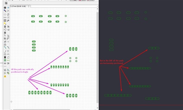

    And I just noticed another issue about the pads, all the vertically placed pads in Eagle are exported horizontaly in the DXF file, this is why the pads are overlaping image
