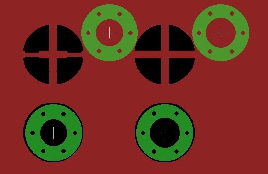

I'm looking for a way to create mounting hole with 6 vias (as a library component) for M3 screw. I was able to create such a package but when I use it on a board and run DRC, I get "Overlap" errors. The vias are defined as small pads since vias are not available in library designer. Is there a way to get rid of the errors? I remember that I was able to define such a component in KiCAD and I' surprised that in Eagle it is that difficult.

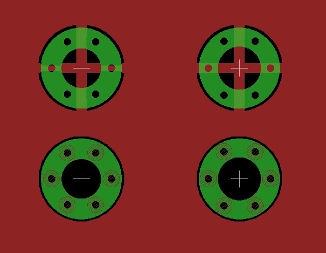

    Wild guess; the small pads should have thermal off, while the big one
    should have thermal on?

    0 markusbass over 10 years ago in reply to autodeskguest
    Thank you very much. yes, this was the problem. Adding a stub net to that pin solved the problem. I'd like to mark this answer as "Correct Answer" but the answer is spread between various posts.
    I have just last question:
    It seems that there are still some differences between my a Warren's library. When I move the grounded pads away, one can see that the thermal tracks generated with my library are different width, while tracks from Warren's library are perfect.
    What can cause this difference?

    I believe your issue is :
    The mounting hole giving the overlap errors has a schematic symbol with
    a pin that is not connected to any net. Perform an ERC and you will see
    the unconnected pin listed.
    Simply apply a stub net to that pin and the overlap errors go away.
    HTH
    Warren

    Thank you - this is almost what I was looking for. Regarding previous remarks to my screenshot: you were right, there were problems with the pad. I created the package as a copy of another package and it looks like I shouldn't do it. I started the package from scratch and got much better results. Actually, the same as Warren presented.
    On the left there are two pads from my library, one connected to the ground and the other not. On the right are two pads from Warren's library. There are just small differences. I have the drill = 3.2mm and Warren has 3.5mm. Warren's pad didn't have the "Thermals" option checked - I had to change it. The problem is with pads not connected to the ground. As you can see, in both cases "vias" as reported as "Overlap" by DRC. How can I get rid of this last error?
