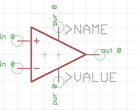

Hello,
I've created a new part for an 8pin dual comparator. The device has 2 symbols, one comparator with the power and ground pins and 1 with just the second comparator pins.
The power and ground pins have their numbers rotated 90 degrees on the schematic. I can't seem to figure out how to rotate just the pin numbers. This is how the symbol looks:

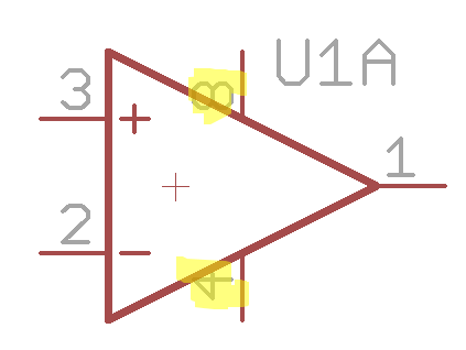

This is how it looks when used on a schematic. The pins numbers that need rotation are highlighted. Can anyone tell me where to fix that?
Thanks.

    This is a question that is asked from time to time.
    Currently Eagle cannot do it.
    HTH

    But this would be a very easy thing - smash from the component and separate properties for the characters - in the library editor.
    The hope dies at last.

    But to the point of the OP, if one were to have the ability to smash the
    pin number and move it around, it pretty much defeats the purpose of
    having pin numbers.
    The biggest problem with the pin numbers is that the component outline
    usually runs right over them.  It's not really a problem - more of an
    inconvenience that is easily solved with the DISPLAY command.
    I say... leave it as is.  There's more important things that need attention.
