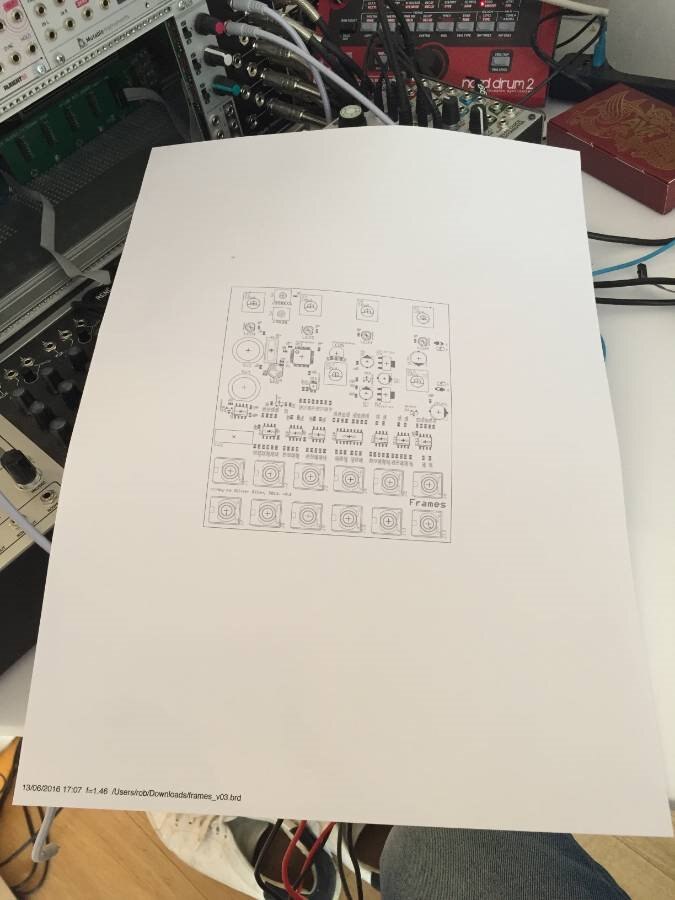

Hi, I'm trying to print a public board layout on A3 but when I increase the scale factor it gets to a certain size and then won't get any bigger. It's as though the print area has somehow been set to be much bigger than the actual PCB (you can see a cross about an inch above the layout but I would have thought it should still scale much bigger) . Is there a way to change this as having a nice big A3 print makes a massive difference to legibility.
Thanks in anticipation,
Rob (Eagle beginner with failing eyesight!)

    move your layout so that the lower left corner of the outline is
    placed at the origin (the cross you mention above).
    Somehow eagle gets irritated - at least in regard to print scaling -
    if the layout is not in the upper right quadrant
    Lorenz
