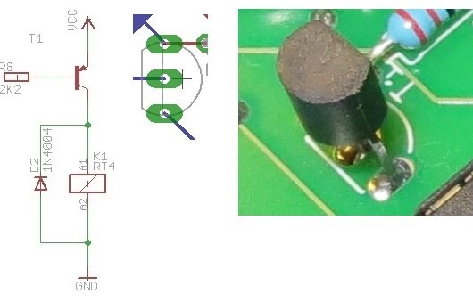

Eagle PCB Layout Editor PNP Transistor E and C pins swapped?
e14 Contributor
Device -> BC557B-PNP-TO92-EBC (*-PNP-)
Package -> TO92-EBC
Library -> transistor
Are the E and C pins swapped somehow when you design the board?
The orientation of the transistor (silkscreen) on the board doesn't comply to datasheets of the above mentioned device.

    0 e14 Contributor over 10 years ago
    Thanks for the responses!
    I hope that Cadsoft does do something about this.
    Picture below shows part of the schematic, board (blue top left is Vcc) and transistor in the working circuit.

    Without further looking I remember that these TO92 packages were really
    some bullshit even far back in version 4.16 image
    Normally in eagle the pads of a device have NUMBERS the symbols have
    NAMES and in the devises the pin names are connected to the
    corresponding pad numbers.
    AFAIK there are only 2 versions of TO92 were pads are in a row or are in
    a triangle and all of them are numbered 1,2,3 and that is it.
    Cadsoft should really clean this mess up.
    For H.J. Windt I suggest to open your own library copy the devices into
    it and rename the pads correctly according the data sheet.
    Package -> TO92-EBC
    The orientation of the transistor pin outs on the board doesn't comply to datasheets of the above mentioned device.
    I believe you are correct.
    I'm looking in Eagle 7.5
    There are many transistors in the transistor libraries using the package
    TO92-EBC that are incorrect.
    There is also the following package with an incorrect name
    Library =  transistor-pnp.lbr
    Package =  TO92-EBC.pac
    The pads are actually CBE
    Perhaps Cadsoft will assign someone to clean up all the  transistor
    libraries.
    HTH
    Warren
