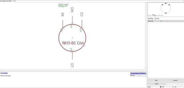

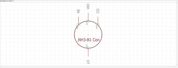

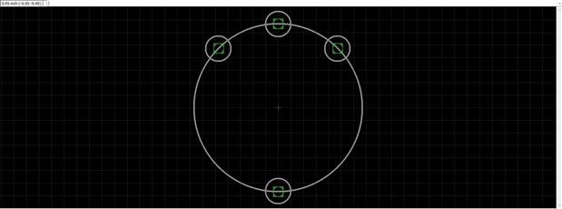

    Hello,
    Enclosed three pictures of the component I created in library. Symbol :
    Package :
    Device :
    Yes, you are right, my component is not on the grid.
    Coordinates :
    RE pin : x= - cos(Pi/4)*8.5mm = - 6.01040764 mm
                   y= sin(Pi/4)*8.5mm = 6.01040764 mm
    CO pin :
                   x= -cos(Pi/4)*8.5mm = 6.01040764 mm
    WO pin : x=0
                   y = 8.5 mm
    LO pin : x=0
                   y = -8.5 mm

    Hi Djib,
    So it looks like you are trying to design your schematic symbol to mirror the size and shape of the actual component for some reason. I can't think of a good technical reason to do that for the symbol. Having looked at the part in your schematics above, it's an ammonia sensor so there obviously isn't a common symbol for this. If it were me I would create a rectangular component like any typical IC, line up the pins on the 0.1" grid in a logical manner (so your schematic flows nicely) and if you want to make it clear on the schematic what the part is then add a box and some textual notes on the schematics or maybe label the symbol itself to say it's a sensor and it's type. I have additional properties in my symbols to specify what they are which I can place visibly on the symbols with >AttributeName much like with >NAME and >VALUE if needed.

    Hi Djib,
    You'll need to use the 0.1" grid for the pins. You can use a finer grid for placing text attributes like >NAME and >VALUE on the symbol so they are nicely positioned and the body of the symbol can be as intricate as you like so you could draw the symbol body with the finer grid to match the connector shape and then place the pins on the 0.1" grid as close to where they need to be on the symbol body as possible and then again with the finer grid draw lines to match them up. The key thing is the pins must be on the 0.1" grid or you'll end up with problems.
