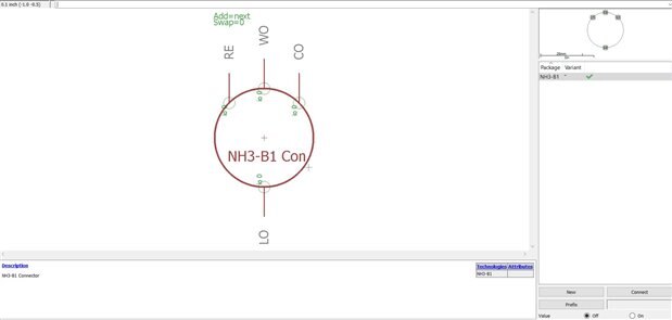

Hello,

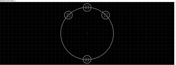

I got a problem because I can't wire to a component I created. First, I created a library for the component with Symbol, then Package and Device.
But when I am using this component on my schematic, I can't wire it. I used the same scale and grid for all the schematics and I updated libraries. But it is impossible to wire it.
If anyone has an idea to solve my problem ?

    In symbol, I don't have the exact dimensions of the connector of the sensor. But I can connect the wires.
    In package, I modified the dimensions of the connector, I put the right ones and I got the exact dimensions of my connector in the layout.
    So, I think the issue is resolved.
    0 e14 Contributor over 10 years ago in reply to rachaelp
    Yes you are right, I put the right dimensions of the pins in Package and it works. I got the right dimensions in the PCB and in the final schematic.

    On 7/25/2016 11:33 AM, djib ty wrote:
    Ok now I can connect wires because I used 0.1" grid but I don't have the good dimensions. For example, I need to have x=0 and y=8.5mm for a pin and I used x=0 and y=0.3 inches (7.62 mm).
    That's a big issue.
    Hi Djib,
    Not in the symbol. It's important to create a distinction between the
    schematic and the layout. In the layout you have to obey physics and
    your packages need to accurately mirror the physical devices.
    The same is not true of the schematic. The goal of the schematic is to
    be a symbolic representation of your design that is easy to read and
    clearly describes your design intent. The symbols in your schematic
    don't need to match the exact dimensions of your component. That's why
    the 0.1" requirement only applies to the schematic and symbol for
    everything else you can use whatever grid is convenient.
    The dimensional requirement you are describing only applies to the
    package not to the symbol, so you don't have an issue.
    hth, let me know if there's anything else I can do for you.
    Best Regards,
    Jorge Garcia

    0 rachaelp over 10 years ago in reply to e14 Contributor
    No, you misunderstand, the pads of the footprint do NOT have to be on the 0.1" grid, only the pins in the symbol!
    That's a big issue.
    Hi Djib,
    You'll need to use the 0.1" grid for the pins. You can use a finer grid for placing text attributes like >NAME and >VALUE on the symbol so they are nicely positioned and the body of the symbol can be as intricate as you like so you could draw the symbol body with the finer grid to match the connector shape and then place the pins on the 0.1" grid as close to where they need to be on the symbol body as possible and then again with the finer grid draw lines to match them up. The key thing is the pins must be on the 0.1" grid or you'll end up with problems.
    Hi,
    In fact, I just want to create a connector for my component. I have to use 0.1" grid or can I use a more accurate one ?
    Moreover, all dimensions are in millimeters in the datasheet of my component. I would prefer use a grid in millimeters.
    ( I succeded to wire one pin but I don't know how I did it, when I deleted the wire and created a new one, it didn't connect, very strange..)

    Hi Djib,
    So it looks like you are trying to design your schematic symbol to mirror the size and shape of the actual component for some reason. I can't think of a good technical reason to do that for the symbol. Having looked at the part in your schematics above, it's an ammonia sensor so there obviously isn't a common symbol for this. If it were me I would create a rectangular component like any typical IC, line up the pins on the 0.1" grid in a logical manner (so your schematic flows nicely) and if you want to make it clear on the schematic what the part is then add a box and some textual notes on the schematics or maybe label the symbol itself to say it's a sensor and it's type. I have additional properties in my symbols to specify what they are which I can place visibly on the symbols with >AttributeName much like with >NAME and >VALUE if needed.

    Hello,
    I understand what you mean but I got a problem with the placement of the pins, I am using decimal values for pins and this is the issue I think.
    You can look my answer above, I showed my schematic and the values of the pins for their placement.
