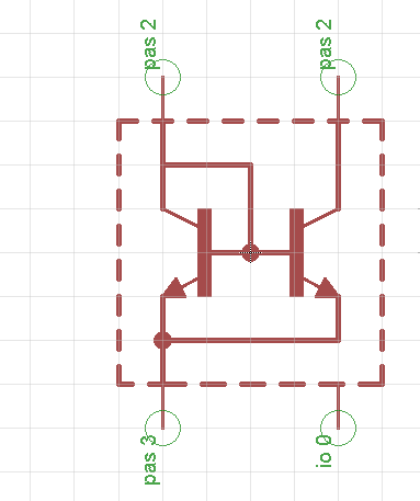

Guys hello.Im trying to add the CA3046 like in the picture below but i can not handle it.anyone can help me?how can i draw this ?

    Seyfullah Gökduman wrote:
    sorry guys im gonna try to be more clear.as you see in the first
    picture,1,2and 3 pins connected to the 4 and 5 pin.i want to split 1,2
    and 3 pins from them.so i want to connect them like in the second
    picture.
    I'm still not sure what you mean ... but I guess you would like to
    split the T1-T2 symbol into two separate ones.
    That is, in this case, not possible because T1 and T2 share pin 3.
    And that is - as Rachael already told you - not possible, because
    eagle can't connect more than one symbol pin to one package pad.
    Lorenz

    sorry guys im gonna try to be more clear.as you see in the first picture,1,2and 3 pins connected to the 4 and 5 pin.i want to split 1,2 and 3 pins from them.so i want to connect them like in the second picture.

    Hi Seyfullah,
    Its unclear what you're looking for, but if it is to draw a symbol a certain way, then it needs to be created as a symbol and added as part of a component.
    For example, this is something I created for a project - you can see that the single symbol has two transistors in it.
    What can't you handle exactly? Your description doesn't really give us a lot to go on. From the title and the picture fragment, I am guessing it may be because you want to create a part with multiple symbols but want to place pins in multiple symbols that both connect to pin 3 of the package? If that's the case then you can't have the same package pin mapping to pins on multiple symbols.
    If you could give us a bit more context on what you are trying to achieve maybe we can give you some other options.
