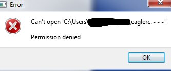

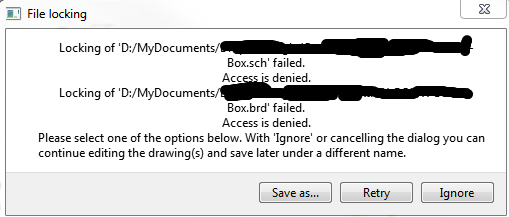

Hi,
When updated to 7.7 I can't save or open files. When opening it says: Locking of  (folder location) schem_2.sch failed. Access is denied.
And when closing Eagle 7.7 it says : Can't open (Folder  ) eaglerc.~~~   -> Permission denied.
I haven't change any folder options and older version are working just ok.

  • ande
    0 ande over 9 years ago in reply to rachaelp
    Hello,
    Just tried to disable file locking from options but no success. Still same message (Locking of.. failed...) and when I exit eagle the Permission denied pop up appears.
    I search whole PC and there are no *.lck files.

  • autodeskguest
    0 autodeskguest over 9 years ago
    Hello Antti,
    I hope you're doing well. What operating system are you using? If you
    are on Windows, did you allow EAGLE to install to the root of C like it
    wants to by default?
    The second symptom definitely looks like a permissions issue with the OS.
    For the first one, just disable file locking completely. If a .lck file
    was created then even if the feature is disabled EAGLE will still
    respect it. In that case you have to go delete the .lck file.
    Let me know if there's anything else I can do for you.
    Best Regards,
    Jorge Garcia
  • rachaelp
    0 rachaelp over 9 years ago
    With regard to the original question, the first symptom is definitely being
    triggered by the file locking system being unable to create the lock file
    but reading the query again it seems there are other file permissions
    issues as it is also unable to access the eaglerc file upon closing.... So
    this isn't being caused by the file locking mechanism I don't think. I've
    not seen any issues like this with 7.7 myself and I haven't seen any other
    reports of people having this issue so I think this is something relating
    to their system somehow. This is probably one for the support guys to try
    and help out with....
