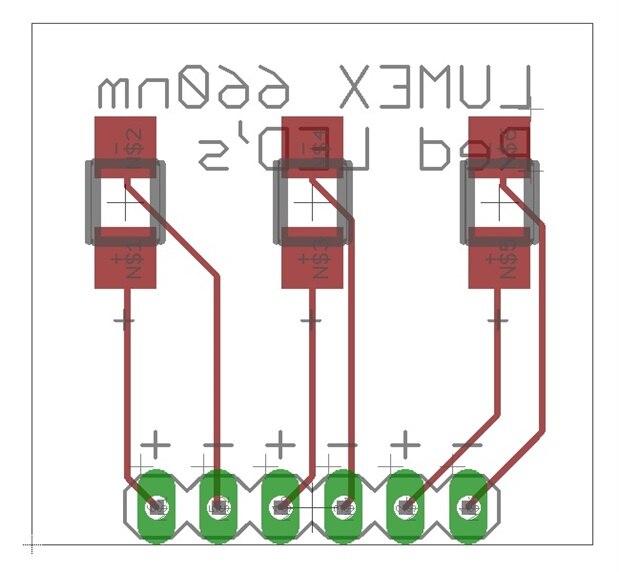

It's been a while since I created a PCB so I probably forgot some things. I have a very simple board for prototyping that's ready for CAM processing. When I try to run the job the progress dialog box will appear then disappear in less than a second. No error messages would show up. I don't know what's going on. I have version 7.7 of the premium edition of Eagle.

    Your board is so simple that it didn't take long to produce the Gerbers.
    Check your directory to see if the Gerber files have been created. You can
    verify the correctness of the Gerbers using GC-Prevue, Gerbv, etc.

    I've looked for any generated files, but I can't find them. That's why I posted here.
    It seems I didn't need the CAM files anyway because I was able to order a PCB with just the board file. But, in the future, I might need to generate CAM files though.

    Hi Michael
    It sounds to me like it ran fine but possibly wasn't set up correctly or didn't put things where you expected. Where are you looking for the generated files? Did you specify the correct CAM job? If so, is the output file location specified in the CAM job you loaded where you think it is?
    Could you give us a screen grab of your CAM processor screen and/or maybe put your .brd and .cam files up here so we can try ourselves and see what is going on?

  • sailmike1
    0 sailmike1 over 9 years ago in reply to rachaelp
    I'm sorry Jorge, but I don't know what you mean by "%N placeholder". Your's and Rachael's suggestions are good ones and I plan to implement them. When I created a Project for that prototyping board, Eagle created a folder called "eagle" in my Documents folder. The Gerbers went to a folder nested deep within my Users folder. I want to develop better organization skills for future projects, so it makes sense to put the projects in the same place as the Examples that come with Eagle. Should I just copy and paste the project folder and put it in that location? I used to have a couple older versions of Eagle, but I lost those programs when my PC crashed some months ago. I'm guessing the old settings influenced this new version of Eagle.

    Hi Mike,
    In general, it's easier to use the %N placeholders since these will save
    the gerbers to the same location as your schematic and board file. This
    will make the CAM job reusable which in my opinion is simpler.
    Near the middle you'll a button that says file and field next to it.
    That's where you specify the location by clicking the file button.
    If you look at the default jobs you'll notice they all have %N in that
    field followed by an extension.
    Let me know if there's anything else I can do for you.
    Best Regards,
    Jorge Garcia
    Hi Mike,
    I agree with Jorge, the only thing different I would do is create a manufacturing folder in the folder containing the board files and set your CAM job to save it's outputs to that sub folder. Then you can zip that folder up easily to send to your board house. If it's in the same directory as your .sch and .pcb and whatever else you have there then you have to manually go select all the gerber files to add to a zip to send to the board manufacturer.
