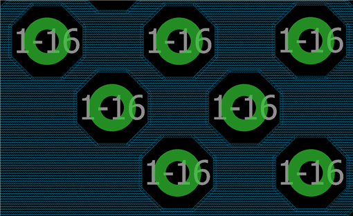

therrm266
therrm266 over 9 years ago
I'm trying to perform a copper pour around a via but it appears to be acting oddly.
I would expect the copper pour to wrap around the via, making a circle with a clearance set by my DRC options.
This becomes a bigger problem when getting a power pour under a BGA with vias; the hexagon shapes waste space.
Does anybody know why it is creating a hexagon shape instead? I have tried adjusting my DRC, changing width of poly, and some other options, but I haven't had any luck.
Any suggestions would be greatly appreciated!
Thanks!

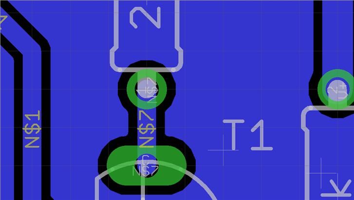

    Hi,
    after rereading:
    are the shapes all with round ending switched on, or rectangle?
    Your image seems that they have rectangle ending.
    Hi,
    It seems that something happens in the layers, e.g. keepout, restrict, 1-16; something invisible that makes this shape.
    Cadsoft liked all in octagonal shapes. Your image shows octagonal shapes, not hexagonal.image
    I've changed the pad shape of the resistor for you to round (it comes from the standard rcl.lbr with octagon shape)
    Thus, the roundness of the copper pour is also "correct" calculated as almost rounded.
    Almost rounded because the calculator draws lines beside lines on grid or off grid. Then it can be happening of rounding errors.
    Look for the knee of N$1 - there is a typical rounding error on the pour of the inside arch.
    / This picture has some small spikes. This is because the image is a png file, a compressed image.

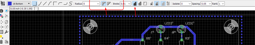

    Hello Therm,
    I hope you're doing well. I've seen this before, its not a bug there is
    usually an issue with the width of the polygon, try using a lower width
    and see if that gives you shape closer to a circle.
    As has already been mentioned, polygons are drawn with a bunch of
    straight line segments so if the width is large relative to the via size
    you may get a hexagon.
    Please let me know if you continue to run into problems.

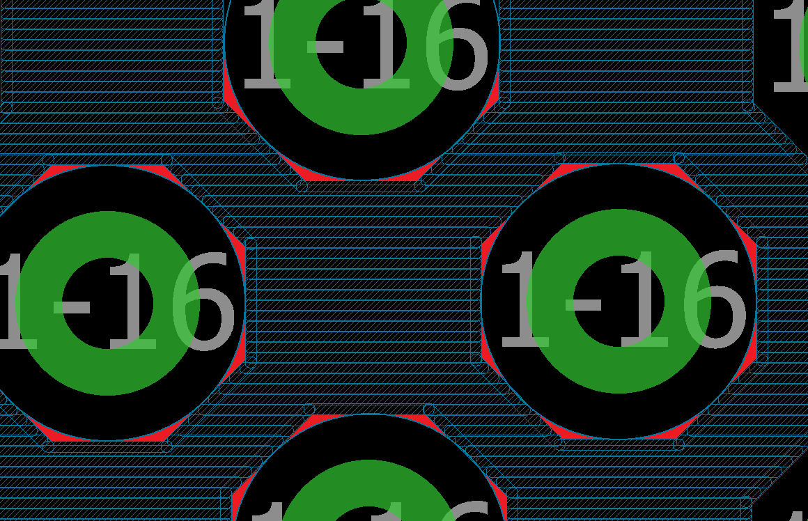

  • therrm266
    0 therrm266 over 9 years ago
    Thanks for all the responses!
    Firstly I misspoke, they are octagons, not hexagons. With that being said, here are some more details about what is going on:
    • The vias are 18/8, and I might use 16/8 vias.
    • The width of the poly is set to 1 mil. I can adjust the poly to anything and it didn't make a difference.
    • Since these are vias, I can't adjust them as easily as I could with a part in the library.
    I know it might look minor, but in the case when you have an FPGA that can pull close to 10 Amps any amount of copper helps. The red sections in the image below show the areas that I'm missing because Eagle is pouring the copper as an octagon instead of a circle.  Each one of those marks is roughly a mil, and when the opening between the vias is only approximately 6 mils, that is two mils I'm missing between them. Proportionally that is quite a bit.
    Again, thank you all for the responses! Hopefully we can figure out a solution.

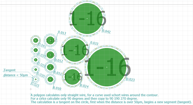

  • Jorge_Garcia
    0 Jorge_Garcia over 9 years ago in reply to therrm266
    Hello Therrm266,
    Sorry for taking so long to reply. Because of the diameter of your vias the octagon shape in unavoidable. See the attached image which illustrates why this is the case. I think this will help clarify the issue for all involved.
    Let me know if there's anything else I can do for you.
