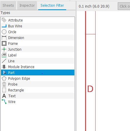

    Alright. So I was facing the same issue. The solution actually was in the selection filter section.. ie the one which has a list of tabs as shown:
    Allimage
    Make sure that the Part option is selected(as shown above). This way you will be able to select the parts for moving.
    Then you can move the parts(or the group, if you have selected a group of parts) by left clicking on the plus symbol of the part(or the group).
    Hope this works.. worked for me!
