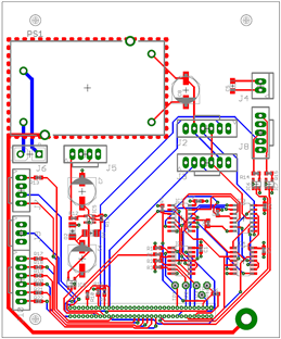

The problem I have is described in the attached images (they are zoom-able).
I have a finalized, fully routed design:
At some point I decided to add a new gate to the schematic, so I copy IC5 and paste it as IC9. Please note that no connections on IC9 have been made yet:
Simply placing this gate on schematic causes significant changes on the board. As you can see, multiple nets become ripped up, even the nets that have nothing to do with IC5 or IC9.
Is it possible to avoid this effect?
Thank you,
Sergey

    Isn't this the simple effect that filled new (implicit) nets gets an
    airwire as you present a new gate with implicit power?
    Yes, and I believe it should not be so, because the power pins of the new gate are not yet invoked on schematic.
    Pressing ratsnest should leave you with only the airwires for IC9?
    That was what I expected, but instead ALL power traces get converted to airwires, even without pressing the ratsnest.

    I was able to solve this problem, and would like to share with you how I did it.
    This is a 4-layer board with the inner layers being VCC and GND. There are power supply traces ob both sides, too.
    I usually keep the inner layers hidden (there is nothing to see there). So I accidentally discovered that having them hidden was the reason of EAGLE behavior as I described: all routed power traces get converted to airwires. However, if I make the power layers visible, then copy and place the new gate, all existing power traces stay preserved and only the new gate has airwires from its power pins to the nearest points corresponding to VCC and GND nets. This state does not change after I hide the inner layers again.
    BTW, this is another oddity that power pins of a new gate get airwired to supply nets automatically, even though the supply pins on the schematic are not invoked yet.

    Hi Sergey
    It's important to say which version of Eagle you are using.
    I use v7.7 (Win7)  and can demonstrate I don't have  your problem.
    Using the example Schem/Board Hexapod I can copy a device in the
    schematic and it appears without air-wires on the board, ready to be
    placed. The rest of the board remains unaltered.
    It may be the technique you are using to copy the part (ah! maybe the v8
    select mechanism has caught you out). I simply right click on the symbol
    (IC5) and select copy from the context menu. Then you will only have the
    IC stuck to the cursor and no nets connected to the pins.
