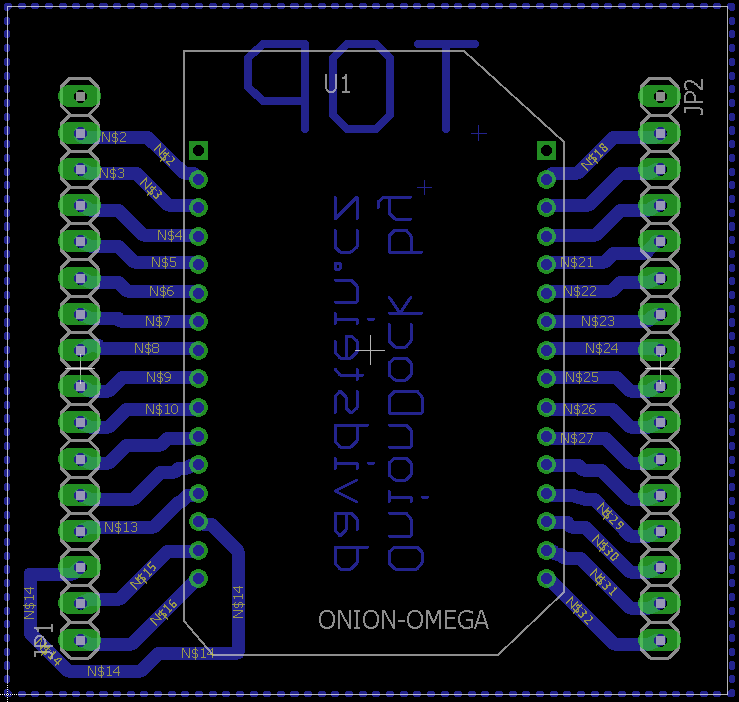

Hi, it is possible to, by pure eagle or with some scr/ulp export my schematic/board as part what can be used again in other schematic ? For example I got 2mm grid to 2.54mm grid conversion dock board.  And want it use in bigger project. So I need to  "lock" JP1 and JP2. Thanks

    Thanks a lot, I was using  old version of eagle so there was no option for design block. I download latest autodesk eagle and works like charm.. Thanks a lot.

    Using the ULP make-group2pac.ulp You can take your board and export/convert
    parts of it to be a package in a library. Essentially the outline (which
    becomes the tPlace) and the pads for the J1 and J2 parts
    Then in the library you would create the symbol to appear on the schematic,
    connect that to the package to make the device.
    HTH
    Warren

    Hi,
    the easiest way is to build a schematic - Design Block.
    Or you can build it as complex "macro" component in the Library.
    The 2. - please repair trace N$14. You don't need going around the Pinhead.
    Sort a bit better all traces. - Then the board will also a bit smaller.
    Gerald
