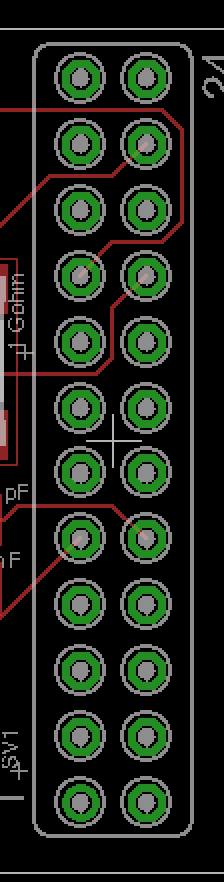

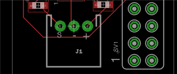

I'm new to Eagle and was looking for some help with making a PCB board layout that I will have fabricated by a board manufacturer. The goal for my project that I'm working on was to have several capacitors and resistors connected with traces to two different through-hole components, a 12x2 pin female connector (something like this: https://www.digikey.com/product-detail/en/sullins-connector-solutions/PPPC122LFBN-RC/S7115-ND/810251.)
and a right angle 3 pin connector (something like this: https://www.digikey.com/product-detail/en/sullins-connector-solutions/PPTC031LGBN-RC/S5439-ND/775897)
I'd like to have the pins of the connectors soldered to through holes where they connect to the traces on the top layer (ideally the only layer) of the board. The plastic of the 12x2 connector should be positioned below the top layer with the pins facing upwards, and the plastic piece of the 3 pin connector should be above the top layer of the board. I've attached a couple pictures of how I have it currently designed in my Eagle board layout.
As for my actual questions:
As it is now, I don't have any through holes that I individually placed on the board, just the through-hole components themselves, so if I sent it to a manufacturer, how would it be printed? Do I need to add another layer to the board and through-holes in order to specify more accurately how I want the board to be made, and if so, how would I do this?
Thanks in advance!

    I'm referring to what you have said:
    ...fabricated by a board manufacturer..
    which means that your THT-connector will be connected through VIAS. That
    means that the pads of your device show on the TOP- and the BOTTOM layer
    with a connection THROUGH the board. That is normal THT technology image
    ...The plastic of the 12x2 connector should be positioned below the top
    layer with the pins facing upwards...
    One cannot  place things "below the top layer" That would be in the
    "middle" of the board between TOP and BOTTOM layer. I think that  you
    actually mean the BOTTOM layer.
    If you really want to place a connector on the bottom layer then the
    device must be MIRRORED.
    So to answer your question about extra layers: not needed.
    You must learn to turn on/off individual layers in your layout to check
    the design.

    Well, with my VIAs answer I have misunderstood the question. Joern is
    right of course:  when you place a correctly drawn THT part from the
    library, all needed things are already included (the drills and solder
    pads and all associated masks).
    For routing, the layers Top, Bottom, Pads, Vias, Unrouted must be visible.
    Everything in the Pads and Vias layer is included by the manufacturer to
    the copper in the Top layer as well as to the Bottom layer.  I.e., the
    solder pads are drawn in the Pads layer but manufactured in the Top and
    Bottom copper.  (Only if you prepare Gerber files or plot films by
    yourself, you must remember to include those layers.)
    Parts are placed initially on the tPlace layer (on the top side of the
    board).  If you need parts on the bottom side, MIRROR them to the bPlace
    layer.
    Hans
