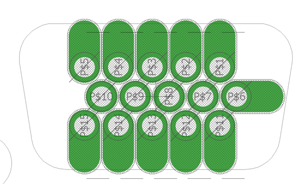

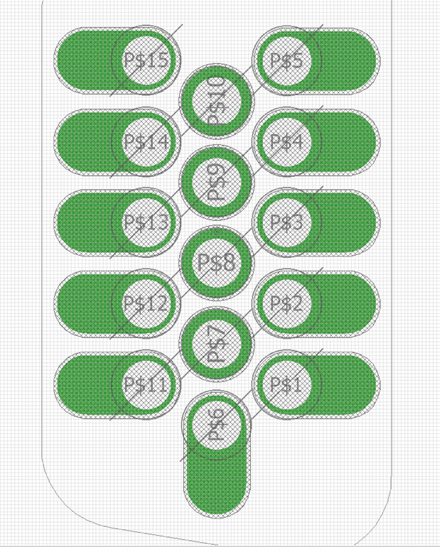

I have created a device and in the package editor the pad spacing looks fine, however, when I place the device onto the circuit board, the dimensions look different and the pads are way closer together.
It is definitely the same package because I can right click the device on the board and go Open Package and it opens the package but it looks different.  The drill size and diameter size has been set manually in the package for all the pins.
Here is what it looks like in the package editor.  Looks fine.
...and here is the footprint when placed on the circuit board, everything is fatter.
Shouldn't they display the same?

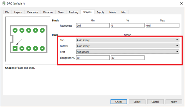

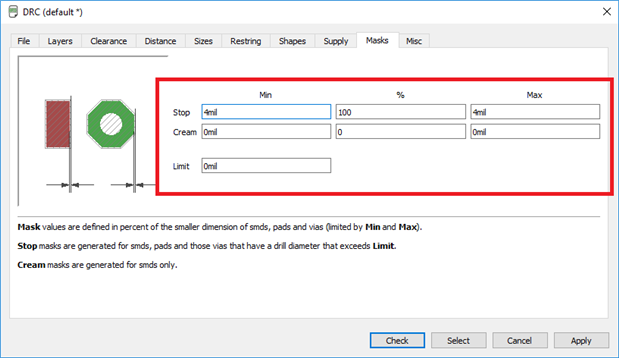

  • jltharin
    0 jltharin over 8 years ago in reply to autodeskguest
    Hi Philip
    In DRC, some options can modify the shape of pads
    Below you can see where, check this option are "As library"
    Hope this can help you
    jltharin
