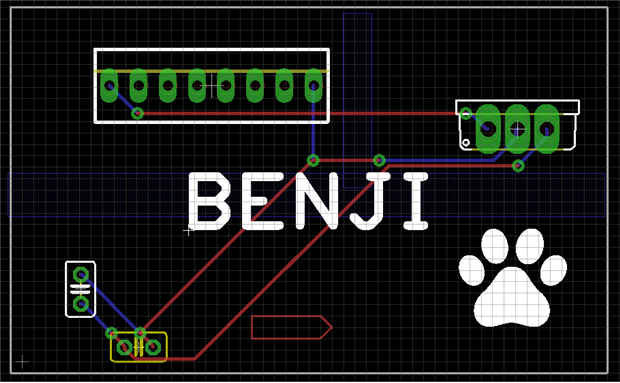

As a hobbyist, I find it much faster for prototyping make my own boards and recently got a CNC router to speed up prototyping. I usually route the boards myself but sometimes don't have enough time to do it by hand. The problem is that while the auto-router works fine for hand-made single sided boards, for double-sided boards, there is no way to turn off PTH for the pads. It will always assume the top and bottom of all pads to be connected by default and route accordingly. As everyone knows, making PTH at home is not feasible(time and money).
Is there any setting to tell the auto-router not to assume pads' top and bottom to be connected?
One way I see is by using a ULP that places pads' duplicate shapes on bRestrict for parts on bottom side and on tRestrict for parts on the top side. Is there any such ULP available?

    Thanks Paul. It was actually because ULPs get all positions and dimensions in Eagle's internal units. They have to be converted using u2mic, u2mil, u2mm or u2inch. The funny thing is all their examples in their ULP manual just prints without conversion as well. Only by going through other ULPs could I find these functions, given only a small section in the ULP doc:
    EAGLE stores all coordinate and size values as int values with a resolution of 1/10000mm (0.1µ). The above unit conversion functions can be used to convert these internal units to the desired measurement units.
    Anyways, I got the script made. It works well and does almost everything I had initially planned. Here it is for those looking for a similar solution:

    Here's a screenshot of a quick test I did. 1 of the caps is mirrored, so will be placed on the bottom side. So traces should only go to it from the top side. The autorouter did exactly that. There are also 2 bRestrict areas separating caps, an 8-pin connector and a TO-220 component. The autorouter only took traces to them across the bRestrict using top layer and then assuming pads as disconnected on top layer, used vias to connect to them from the bottom layer. So yeah, works perfectly!!!

    Ah ok. I know the autorouter isn't too good but sometimes you're in a hurry and instead of spending an hour figuring out the best layout, you just want to let the autorouter dp your work and modify it to your requirement. Still think the ULP method I mentioned in the original question is the way forward. Thanks for your suggestions.
    0 genebren over 8 years ago in reply to antzy
    Antzy,
    That is a good point. I do not have the auto-routing feature on my software (license) so I can not test any of the settings.  Even when I did have the correct license, I found that the auto-router did a very poor job, so I would never use it.
    You might be able to manually place vias in the area where the component limits your access to both the top and bottom.
    Just a thought.  Good luck finding a settings based solution to your problem.
