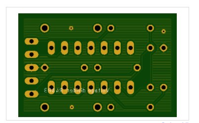

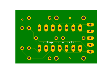

Hi everybody,
the first image is my pcb on eagle - board layout -, but when i generate the Gerbel file, the bPlace was in a wrong position - second image.

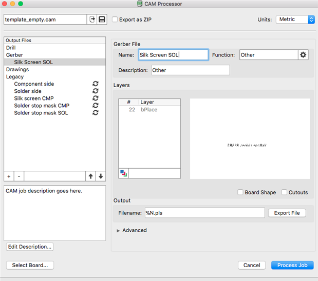

I use this guide to add the "Silk Screen SOL": https://goo.gl/ujCzQc   - third image - .

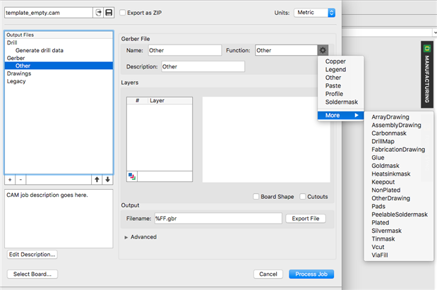

    All the new gerber output are create in X2 format.
    I seen that the extension is always x.gbr in X2, but when i convert the legacy files it remain the old extension. If i left the new x.gbr extension, the gerber viewer can will have some problem?
    Could you explain me the parameters in the last pic?

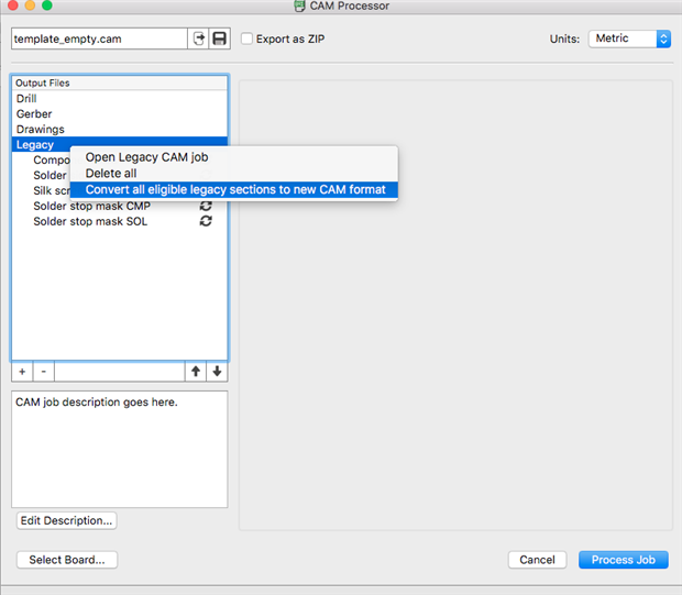

    Hi Dave,
    I hope your doing well. The main issue here appears to be that you have mixed a legacy CAM job with the new Gerber file format. The offsets are calculated differently in each system so you shouldn't mix them. The recommended solution is to convert all of your legacy sections to the new format and export the gerbers then. You can do this easily by right clicking the word Legacy and you'll see an option to convert all of the sections to GerberX2.
    Alternatively, you can have everything using the legacy system. That will also work, the key here is that you don't want to mix them.
    Please let me know if there's anything else I can do for you.
    Best Regards,
    Jorge Garcia
