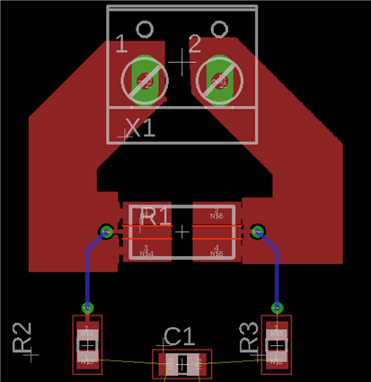

Hey everyone!
I'm still learning eagle, so some obvious things are still difficult for me to wrap my head around, but I'm learning!
I have a question regarding Kelvin connections in Eagle. I have a board I need to design that performs current sensing. It has 2 input jacks, 2 output bnc jacks (that go to a differential amplifier) and a shunt resistor to measure the voltage drop across. My supervisor has asked me to implement the following pad layout for the kelvin connection with this shunt resistor: https://www.bourns.com/docs/Product-Datasheets/css2h-2512.pdf
To do this the only approach I could come up with was to design a new footprint for the shunt resistor in which both sides have 3 pads. So I came up with this footprint (Bourns_CSS2H-2512-A in this library: https://github.com/joshvandermeer/Eaglelibrary )
Then when I try to connect to the pads manually using the polygon tool in eagle, I get the following:
Where it looks like each pad has a maximum trace width for the trace connecting to it. This circuit will have a high current, so I want the traces to connect completely, not just by a thin trace at the terminals.
Is there anything I can do to improve this situation? I'm new to this, so I'm sure I'm overlooking something important, and I really appreciate any advice!

    Thank you both for the great advice. I agree that the implementation I was shooting for was very overcomplicated. I'm an intern right now and trying to take as much instruction as I can. I was given this document to follow, but there was a miscommunication and he just wanted me to learn from it, not actually implement it.
    Optimize High-Current Sensing Accuracy by Improving Pad Layout of Low-Value Shunt Resistors | Analog Devices
    Ended up just taking the kelvin connection from the inside of the pads.

    0 autodeskguest over 8 years ago in reply to rachaelp
    On 15.10.2018 11:01, rachaelp wrote:
      wrote:
    I think you are way overdoing this circuit, and at the same time you
    weaken it. If the resistor is tightly dimensioned for your power, you
    need the full pad both for heatsink and current.
    Just route the kelvin probes out on the side of the SMD pads.
    Joshua does say in his first post "My supervisor has asked me to implement the following pad layout for the kelvin connection with this shunt resistor". It might not be what you would do, but it is what he was asked to implement by his supervisor.

    If this was me, I would go back to my supervisor and demonstrate my
    skills and tell him about this implementations weakness but it may not
    be the right thing for Joshua this time. That's up to him.
    To add more feedback to his supervisor, Im not even sure if a
    manufacturer would like this implementation, due to it's potential
    bistable nature. When the lead melts, this got a bistable nature of not
    falling to rest on the large pads, but may be pulled to one side or the
    other.
    On 08.10.2018 17:06, Joshua Vandermeer wrote:
    Hey everyone!
    Just route the kelvin probes out on the side of the SMD pads. The point
    of the kelvin probes are to avoid the voltage drop in the high current
    main path. If you just bring out some probes on the side of the smd's,
    there will be close to no current generating voltage drop on those
    tracks. If you want max noise immunity, route the two tracks
    differential back to the sensing circuit. For even more noise immunity
    route them through directly down a VIA to a different opposite layer.
    The implementation of the kelvin probes is done at the board layouyt,
    not the schematic, but if you need others to do the routing job based on
    your schematic drawings, draw it like you would route it and put a
    comment in the schematic at the info or guide layer.

    0 jjvan over 8 years ago in reply to rachaelp
    Rachael,
    Thank you! Ya I fumbled around with it more and improved the resistor footprint to have pads better defined and that helped fix my problem. I'm just getting started with Eagle so I'm learning all the intricacies of how to properly create a part.

    Hi Joshua,
    It looks like there are more issues than just your connection widths. If you look you actually have the signal polygon fills shorting with your sense trace. You need to do your footprint and your schematic symbol to allow the 4 terminal connection. So on each side the two outer pad pieces connect to the corresponding main resistor pin and the central pad connects to a separate current sense pin with a separately named net. I'm at work at the moment so can't explain further but if you are still having issues I will try and explain better later.
    With regards to the connection, turn off thermals for the polygon and then it will connect fully.
    Best Regards,
    Rachael
