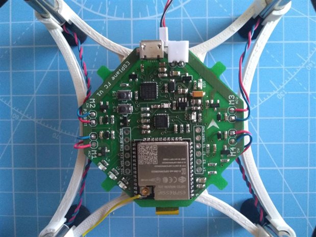

I am designing tiny flight controller for smartphone controlled plane and drone... rev-0 of the same is approx 5cm x 5cm and all components on top as per pic below..
now I am trying to reduce size and weight of flight controller board by using WiFi SoC chip rather than module and  placing components on both side of board ...
Please suggest considerations for placing components on both side of PCB board so it can be made by machine (Automatic placement and reflow machine)
Key Parts:
ESP32-PICO-D4 chip QFN
CP2102 USB-UART chip QFN
MPU6050 ACC-GYRO QFN
Misc-SMD LEDs, Resistors, Diodes, Caps, LDOs, BJTs, MOSFETs
Thanks,
Ravi
  • michaelkellett
    0 michaelkellett over 7 years ago in reply to clem57
    Hey Clem, that's a bit out of date !
    I think Ravi will be into 0402 and a PLCC would be bigger than his drone image (well, not quite).
    It's much more common with fine pitch work to use solder paste and reflow on both sides of the board.
    MK

      Maybe two single sided with minor edge connections between them can be
    done?
    as Morton suggested...

  • clem57
    0 clem57 over 7 years ago in reply to clem57
    5.9 COMPONENTS NOT RECOMMENDED FOR BOTTOM PLACEMENT
    Some types of components are sensitive to the higher temperatures of wave soldering and should not be used on the bottom of boards where the solder wave would contact the component. Other types of components may not be suited to wave solder because
    of their lead configurations and size. The following is a list of components to avoid placing on the bottom of a board to be wave soldered:
    Large body chip caps, package types 1812 and 1825 may crack when exposed to wave solder.
    Memory and static ram chips which may be damaged by high temperatures.
    The 1206 should be the smallest package size used on the solder side of the board. Smaller packages such as the 0805 are not well suited for epoxy application and wave solder.
    PLCCs as the lead configuration is not suited to wave solder.
    SOTs do not solder well due to leads being too close to component body.
  • clem57
    Here is a guideline to follow :Component Layout Considerations – PCB DFM Part 4 | Seeed Studio Blog
    or maybe https://www.smta.org/chapters/files/Arizona-Sonora_Design_for_Manufacturing_-_Adan_Ortiz.pdf
  • autodeskguest
    0 autodeskguest over 7 years ago
    I know others made the drone structure out of PCB material. It is
    probably lighter than your 3d printed frame?
    You could do thinner pcb for this, but it will become softer. Maybe two
    single sided with minor edge connections between them can be done?
    You may want to look at the center of gravity if you want to balance the
    potential effect at max power on each motor. The way it is now, I assume
    the lower motors will need to work harder to accelerate.
    Wifi-soc chip will save a couple of grams, but risky if you need optimal
    RF coverage.

    In fact.... I need more care while preparing layout coz many of the parts may introduce interference i.e. motor driver mosfets carrying high frequency (33kHz) switching current in Amp (1Amp to 2Amp) on board...
  • geralds
    0 geralds over 7 years ago in reply to ravi_butani
    For example, if you place a resistor (or other warming components) underneath the RF module on the bottom, this resistor can heat the module up.
    That's what you have to see too. Or RF parameters could change because such components cause EMC problems.
    Sticking the components on the bottom is relatively, nominally correct.
    There are solders that can hold the component well. But, it works only on small components.
