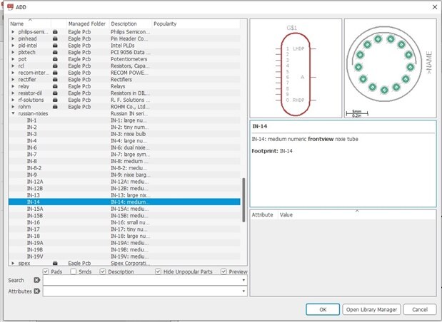

Hello   I  m totally new to Eagle but I have used Autodesk's TinkerCad   so I have use some CAD (however basic) before.
I am totally frustrated with even the most basics ops of Eagle.
I tried to draw a new schematic, so I selected <NEW> and <schematic>.
I went to ADD (a part) and I cannot find MY library.
The only library that opens is the Eagle one (managed).
How do I find MY library folder after hitting ADD?
I know it's there because I can see it in the control panel. Thanks
OK...so I found the part (Nixie Tube 1n-14)  and I want to use the "pin-out" pattern (Shown in the upper right corner)
But when I hit OK the other pattern is used, the one in Red (and I don't even know what that is).
So how can I get the tube pin out pattern onto my schematic? Thanks

    0 dukepro over 6 years ago in reply to celestine
    Patricia,
    The libraries available are listed in the control panel.  As you
    mentioned, your library is listed there.  From that presence, your
    library path is correct and does not need to be changed for this purpose.
    Every design uses a specific enumerated set of libraries.  There's no
    reason for Eagle to load /all/ of the libraries when only a few will be
    used.  The USE command will open a dialog box and allows you to pick
    which libraries will be included in the current project.  I suspect that
    your custom library is not in that list.  To get to this, you can type
    "USE" into the command text box, or you can click on Library->Use.
    To reverse this process (i.e. to un-use a library), use the ADD
    command.  This is the same command used to add components to a
    schematic.  The dialog box provides the opportunity to select a library
    and "Un-Use" it, thus removing it from the list of libraries used by the
    project.  To do this, you can type "ADD" into the command text box, or
    you can click on Edit->Add.
    It is pertinent to note that removing a library from the list does NOT
    remove the devices already one the schematic that were sourced from that
    library.  Un-using the library merely takes it off the list of libraries
    from which components can be /added/ to a schematic.
    Caveat emptor: This advice applies to Eagle v7.7.
    Best regards,
        - Chuck

  • celestine
    0 celestine over 6 years ago in reply to autodeskguest
    Im using Windows 10
    Eagle 9.6.2
    As for the rest of what you said to do....really I have no idea what you telling me to do.
    Shouldn't I be able to click on "libraries" tab at the top of the schematic page and just open the folder I need?
  • autodeskguest
