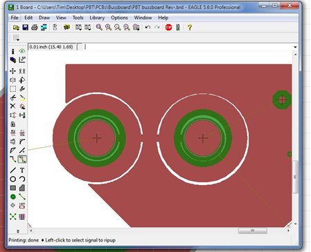

Hello:
I  am trying make a large pad diameter of 0.900 inches, and maximum pad  dia. allowed in Eagle is only 0.51 inches. Is there a work around, or  another way to get a large pad size?
I tried making a circle on the same layer as the maximum allowed pad (Pads) that overlapped the pad, but that did not work: It would not connect to a copper pour polygon of the same net name.
Thanks for the help!

    0 e14 Contributor over 15 years ago in reply to e14 Contributor
    Thanks Tilman,
    I tried your method, in the library editor, I made two 180 degree arcs on the top copper layer overlapping the pad on the pad layer.
    Trying to put a copper polygon pour of the same net name in board layout unfortunately does not connect the new copper arc pads to the top copper polygon.image
    I can connect with a trace of course, and simulate a thermal on the pour by hand, but I would like the new pad to look just like a regular pad and connnect to the pour with thermals or without thermals, either way would be fine.
    Tim Economu schrieb:
    Thanks Tilman, I tried your method, in the library editor, I made
    the pad layer. Trying to put a copper polygon pour of the same net
    name in board layout unfortunately  Image:padnotconnectedtopour.JPG
    a) If you put images in that badly broken webgate, they never appear in
    the original newsgroups or in the other (significantly better working)
    webgate.
    b) You didn't mention before that you want to do this within a library
    (i.e. package). The method I described is fine directly in the board. In
    a package, you better draw a round-appearing polygon (outlines also
    built with two ARCs). It will be "merged" with an SMD pad inside (that
    you need for defining the connections).
    Tilmann

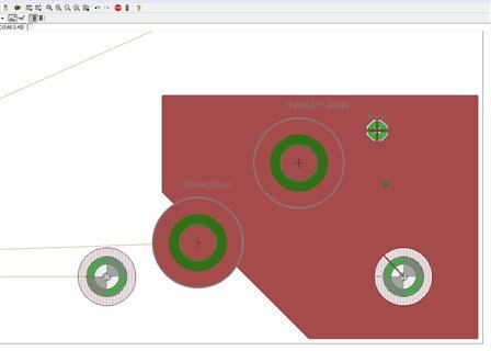

    THANKS SO MUCH!!
    In the attached graphic you will see the work around. A polygon can be used but not arcs or circles (strangely enough!).
    So thanks again both of you, really appreciate having a new library item for my large pad!image
    On 08/31/2011 07:17 PM, Tim Economu wrote:
    Thanks again for the help Tilmann,
    About your answers,
    a), I really have absolutely no idea what you mean. I have been using Eagle for maybe 6 or 7 years now, and really never needed much support until now.
    b) I am asking about how to build a pad larger than the Eagle default of 1/2 inch. That is (as far as I know) only possible in the library.  As I said I tryed using two arcs to define a larger pad, on top of the existing .5 inch pad, and as the image shows, the copper polygon pour will not connect to the new copper pad. If I delete the "new" larger pad made of arcs, the existing .5 in pad 'will' connect to the pour.
    I find it hard to believe there is no easy way to get a larger than 0.5 inch wirepad in Eagle!!
    Thanks,
    Tim
    Eagle version???
    with 4.1x you can't really add copper to lib's. With 5.+ I think you can
    but I never upgraded.
    With eagle 5.+ in the lib make a square polygon and then round with the
    miter tool.
    With 4.1x fix the stop mask to the larger size then use a named polygon
    on the board.
    Paul R.
