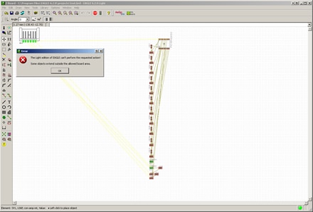

- All the components are located under each other.
I pick up the first to move to a better location and get:
"The light edition of Eagle cannot perform action. Some objects extend outside allowed board area".
No board edge is shown so I do not know where the boundary lies.
I assume you need to set the board size somewhere, but I cannot find any menu item that suggests this.
The help does not offer any solution.

    There is normally a Half Euro card outline turned on in the Lite version.
    Perhaps you have the Dimension layer (20) turned off.
    HTH
    Warren

    The freeware version is size limited, EAGLE enforces that by limiting
    component placement and trace placement to a rectangle whose left-bottom
    and right-top corners are located at (0,0) and (100mm,80mm). When you go
    from schematic to board you notice that all of your components are
    initially outside of this limited area, this is the only time they're
    allowed to be and you're only allowed to move them into the working
    area, otherwise EAGLE gives you the license conflict warning.
    I suddenly realized something. The coordinates of the rectangle you mentioned are located outside of the screen. I zoomed out and placed the component, and it does work.
    As a suggestion for others who might bump into the same situation (and frustration). Is is possible to outline the limited area so it is visually clear where it is possible (or not) to place the components?
    Thank you.

    Thank you for the clarity. However, what you describe is not what I experience. After switching to the board editor I indeed get the components spread outside the allowed dimensions. I then pick up a component, but are not allowed to place it anywhere, as show in image below.
