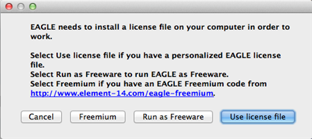

    I will try to write down step by step, what 's happening when starting up eagle.
    I have been working yesterday and today on Eagle on my iMac (desktop computer). Now I will start up Eagle on my MacBook Pro (notebook). On my iMac I have closed Eagle.
    After starting up Eagle, the first thing I get is the license window:
    Choosing "cancel" closes the program
    Choosing "Freemium" gives me the opportunity to enter a Freemium code
    Choosing "Run as Freeware", opens Eagle, but after choosing the license information, it mentions the the singel user freeware license for educational use only. But apparantly, at first sight, the program works, but in the title of the program window there is "Eagle 6.2.0. light" mentioned, so I expect some freeware limitations. After closing Eagle and restarting up, the license dialog isn't showing any longer, but Eagle is still in "light"-mode.
    Choosing "Use license file", I'm asked to enter the license file and installation code.
    Now you could think: the license file has never been installed on the MacBookPro (but it was). So now I have entered my license file and installation code, so now Eagle is showing in the title: "Eagle 6.2.0. Professional". Quiting and starting up gives no problem on my MacBookPro.
    Also, on my desktop, I'm able to start up Eagle without any hassle about license file. So at this moment, I'm running Eagle on both computers. I'm sure tomorrow this will not be possible any longer. Now I will restart this desktop computer to see what happens afterwards and at te latest tomorrow I will keep you informed about the situation.
