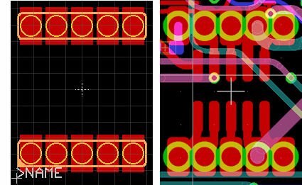

Hi
I've been using eagle for over 10 years. Currently using Eagle 5.12.
I am using some smt bottom feed through recepticles from mill max PDFs below.
actual part -http://www.mill-max.com/pdf/datasheet/pin_rec_catalog/8874-0-15-01-11-27-10-0.pdf
footprint- http://www.mill-max.com/pdf/datasheet/sockets/388-44-102-11-740799.pdf
How do I make a pad with a plated through hole in it's center, without causing an error?
Thanks,
Kim S.

    It's not possible to make that footprint in Eagle without errors
    Eagle Version 6  cannot make it either.
    Plated holes can only exist if you use a pad the DRILL  of which is  plated
    through.
    A HOLE which is not plated through does not meet your requirements.
    So it seems you need to use a PAD. Alas the DRC will adjust the pad so the
    restring has width and that will spoil your footprint.
    So it's back to the hole again.
    You could instruct the board house merge the HOLES and DRILLS files so the
    HOLES are plated through. You could manually do this yourself.
    A ULP would be useful for that. Maybe there is one.
    So the package becomes two SMD pads with holes. Alas there will be DRC
    errors that you will need to approve.
    I have suggested previously that Eagle needs a  HOLE parameter named 'PTH'.
    If it is 'true' the HOLE is treated as a DRILL, is plated through and the
    signals (pours) don't keep clear of it so the PTH connects to copper. In a
    package this hole/drill would need to be considered part of the SMD /Contact
    and not generate a DRC error.
    HTH
    Warren

    Yes, The package looks fine in the libray (I put the pads on a metric grid and the holes on a english grid to avoid the overlap error) until I add it to the board, then the DRC changes the diameter of the holes of the pad within the smd pad, causing the edges of the pads to touch eacother. Of course if I change the DRC setting the rest of the board is affected causing other DRC errors.
    The pcb printing house I use typically plates holes, I just want to make sure the holes are connected to the pads correctly. Perhaps I should contact them and confirm this...
    Here's a screen shot of what happens when I add the part to a board. Note the board has other violations which are the least of my concerns at the moment. First image is in the library device editor, second image is in board.
    Kim S.

    Good to see your usage on a board.
    Remember the PTH is done before the traces are etched so the barrels will
    be fully formed and you need only approach the pad from one side as
    soldering in the socket should fully fill the hole and attach to the other
    side of the pad.
    There is a way to make it work if you don't mind negating the RESTRING
    settings/protection of the Design Rules (DRC)
    In essence, what I'm about to suggest here results in the behaviour most
    people expect work when they begin with Eagle so it should not be an issue
    working this way.
    If I make an incorrect statement during this explanation I hope someone
    will correct me.
    Two areas need changing
    The DRC rules for the RESTRING
    The PAD diameter of all parts in the library that you use in this design
    with the changed DRC
    Change all  the RESTRING settings (top, inner, bottom)
    % of drill diameter = 0%
    Minimum = 0
    This causes the DRC to calculate the RESTRING with a width of zero.
    What appears on the board is the greater of the DRC calculated width or
    that specified in the library package.
    For most of the packages provided with Eagle the diameter is set to AUTO
    which for this point in our discussion means 'use the DRC calculated size'.
    Note that what you see in the library at this point (diameter set to
    AUTO)is not the DRC calculated size but a size based on, I suspect, the
    default DRC setting. But that is simply to provide a reasonable looking pad
    in the package view. In the background the diameter is likely zero so the
    DRC calculated size will always win.
    So with AUTO set for the pad diameter and our new 0% DRC settings, above,
    we get no restrings!!!!Just what we need for your footprint. But it happens
    for all pads on the board. We have to fix that.
    For the other packages used on the board we need to change the PAD diameter
    from auto to a specified size. That then becomes the larger of the two
    sizes(zero is the other size) and it is displayed on the board. This is the
    way novices think it should work, i.e. The way it is in the library is how
    it should be on the board, with no change.
    What has been lost from the DRC is the automatic creation of minimum
    restrings as specified by board houses.
    It is not hard to ensure when you set pad diameters manually that you
    exceed typical requirements.
    In v6 you can make a footprint exactly as depicted in the datasheets you
    identified. There would be no DRC errors(still requires the above
    arrangement though).
    With v5 you could compromise by using a LONG PAD which results in a length
    close to that in the datasheet. Just accept it has round ends.
    I feel some board houses may advise that there is insufficient copper
    (Restring) around that PTH hole so you should advise in the documentation
    you send them that it is not a design flaw and is required.
    The method may cause quite a bit of work if you have many pads in your
    libraries set to a diameter of AUTO.
    If your board is basically a SMD design with only a few devices with PADs
    then you could modify only those library packages involved.
    For other boards you would set the DRC back to its defaults or what is
    normal for your usage. The DRC settinga are retained within the board so
    there is no issue as you move to other boards that used the more normal DRC
    settings.
    I feel this restring functionality is one of a few legacy behaviours in
    Eagle that need changes due to the reducing geometries and higher densities
    experienced these days.
    Hope this helps
    Warren
