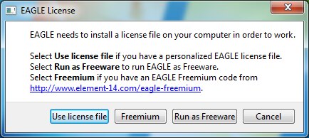

I installed Eagle about a week ago and started working on a schematic. Now when I open Eagle, I am prompted with how I would like to run it just as it did the first time I ran it. I select the Freemium license button and enter my code again but I am prompted that the code has already been used and cannot be activated from this machine. I am trying to learn how to use Eagle and get a board made but this sure is not helping. I intend to purchase Eagle but I am loosing confidence in the product.

    Hello Sam,
    The Freemium is tied to a MAC address none of our other versions of
    EAGLE are though. So if you want try the freeware and you'll see that it
    works just fine. The pro,standard, and Light versions will also work
    because they are not dependent on MAC address.
    Let me know if you need any help.
    Best Regards,
    Jorge Garcia

    Hi Steven,
    The freemium license is the only one that ties to a Mac Address. The
    main problem with that is if for example you had a wireless dongle
    plugged into your computer at the time of installation. If EAGLE picks
    up that dongles MAC address, then in order to use EAGLE the dongle will
    always have to be plugged into the computer in order to work.
    The other licenses rely on a 2 part encryption scheme to unlock the
    license so you wouldn't have to deal with this if you used the hobbyist
    license.
    hth,
    Jorge Garcia
    Cadsoft Support

    Hi Richard,
    I hope you're doing well. I think some clarification is in order. First,
    a freemium code can only be used once, it can not be moved between
    machines. If you're using something like Windows 7, it may not be
    allowing to write a key file in the program files x86 folder.
    Try this, uninstall EAGLE and then reinstall it in the Documents folder
    instead of the Program files(x86) folder that way it's free from any
    tampering by Windows.
    At that point you may have to get another freemium code, but that would
    be it. Keep in mind that the freemium is not to be used for commercial
    purposes(aka generate money), only for educational or evaluation purposes.
