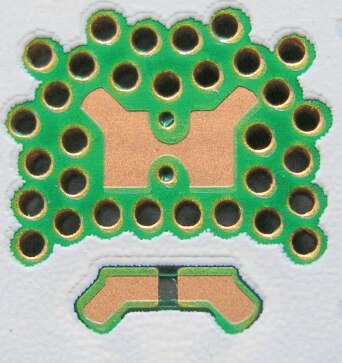

   I am relatively new to EagleCAD & PCB design, but I am doing a pretty basic board layout with some Philips Rebel LEDs. I am in the schematic layout for these LEDs, & have connected all of my +/- leads. Every time I go to do the ERC, I get a "No Supply for Power pin BLUE1TH TH" where BLUE1 is the name that I assigned to the LED. I used the invoke command to pull out a "hidden" thermal pin for each LED, but I have no idea where to connect them. Any advice?

    It would normally say in the data sheet if it needs to be connected to something specific such as GND.

    So I found in the data sheet that "all thermal pins need to be connected to a net named TH", which I did, & it removed the ERC error. But now when I go to the board layout, the autorouter adds a trace connecting all the thermal pads. What is the function of this?

    So late last night I added a "TH" ground-connection to all the thermal pins of the LEDS. Then on the board layout I connected all these "TH" connections to a bottom layer ground/thermal plane. All the errors went away! The only question is, did I do this correctly? Guess I will get the board made & find out...

    Electrically this should not be a problem because thermal pad is isolated. So it's all about if you've put down enough copper to disipate the heat generated.

    The ground plane covers most of the back of my board, so there's a fair amount of copper.  I placed a cut-out in the ground plane solder mask behind the LEDs so I can make a good connection to a heat sink, but I haven't used one yet.  With 3 LEDs at full power (about 6W total supply) the contact area gets quite hot to the touch.  I wouldn't be comfortable running it that way for an extended time but heat does not seem excessive.  I expect a modest heat sink to do the job.
