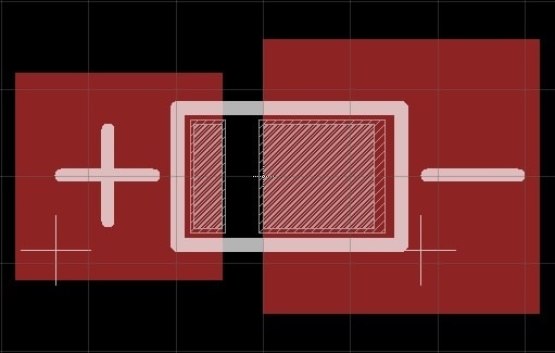

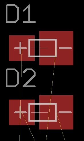

I'm making a prototyping board with 4 different kinds of LED's. When I rotated some of the parts, the drawings I added to the parts in the tplace layer got moved a bit. Will those show up on the board exactly as I see it in the board editor or will they show up as I see it in the parts editor? How do I fix this? Will it be a problem if I send it to the board house as it is?

    The part in the upper picture is smashed, the one in the lower not.
    So I assume you smashed the upper one and resized and moved the name
    and value texts.
    Lorenz

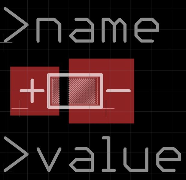

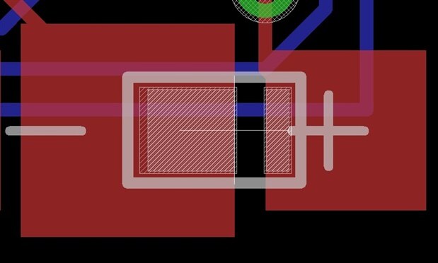

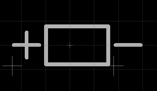

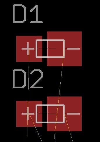

    I've added some before and after photos. In the first is the part before rotating one of them. The second is after rotating 180 degrees. You can see that the plus and minus signs shifted a bit. Rotating the part 180 degrees back to it's original position puts the plus and minus signs in the right place. I just learned what smashing the part means. I just tried that and it didn't work. The plus and minus signs were added to the tplace layer for the part in the library package editor. I created this board just for experimenting and illustrating the problem better.

    Are you sure the plus and minus are in the tPlace layer?
    I note that the plus and minus are a lighter colour than the body
    outline of the diode. If both are in the tPlace layer they should look
    the same.
    It would be a good idea to post the library so we can experience the
    issue and determine if it is a bug or a user issue
    Warren

    The plus and minus signs are both in the tplace layer and, if there's any doubt, I've attached a photo with just the tplace and bplace layers showing in the library package editor. I tried changing the text to vector and fixed. They were originally in proportional format. I also tried changing the fonts to vector and fixed in the board editor. I updated the board after making the changes in the library package editor.

    Solved the problem! I finally noticed that the ABC+ icons were showing up so I tried clicking on the move icon, then the part, and then the upside down ABC+ icon and that corrected the problem. Clicking on the information icon and then the part and checking the spin box fixes them.
