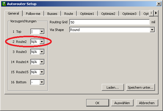

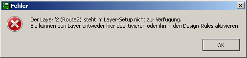

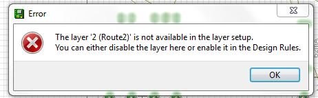

I have clicked on something and am not sure , when I use auto route I get the attached errorimage
What have I pressed and how do I reset it ?

    Hello Steve, maybe the following procedure helps: Unload/close all projects Restart eagle Create a new board Open the "Autorouter Setup" and save the settings to a file ("Save as...") Open your old project…

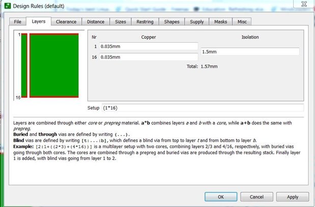

    maybe there is a wrong setting in your design rules. You can open the "design rules" dialog within the board editor. Choose "edit" => "design rules". In the "Layers" tab the "Setup" value for a double sided layout should be "(1*16)".

    Hello Guido,
    Thank you for your reply , Mine is looking like yours .  Is the free version limited ?
    I have done double sided boards before

    There might be a wrong setting in your autorouter setup. Select "Tool" => "Autorouter..." in the menu of the board editor.
    In the free version you are only allowed to set the prefered direction for the "Top" and "Bottom" Layer.

    Looking at your image 1 Top has a | , and the 16 bottom is -
    Mine is set to - on each .
  • steve999
    0 steve999 over 11 years ago in reply to steve999
    have changed 1 top and 16 bottom to the same as yours , and it is working in  a fashion but not making via's now  ?
    1. Unload/close all projects
    2. Restart eagle
    3. Create a new board
    4. Open the "Autorouter Setup" and save the settings to a file ("Save as...")
    5. Open your old project an load the stored settings ("Load...).
    HTH

    Hello Guido.
    that worked thank you
