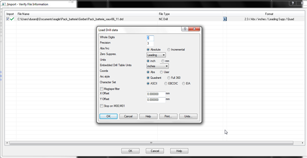

Hello, I have a problem with the Exellon Cam job.
My eagle.def is the original (in INCH)
but when I do the Exellon job, I have a X&Y shift and the scale is bad...
See the attached picture : I opend the .drd file and my .sol & .cmp gerber on the same sheet
Have you got a solution?
Regards,
Jean-Romain

    0 e14 Contributor over 11 years ago in reply to t0bias
    OK, I think I have fond a solution:
    With this file, the drill data is not correctly recognized. My format is EXELLON_2_4 and my gerber viewer set 2_3. This mistake explain the 10 factor!
    see the attached picture
    So you can change the precision digit from3 to 4 in my case.
    Are there any command in Excellon format to specify the format inside of the file?
