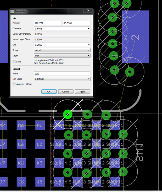

    here is a better picture / explanation: Wire "SW1" is Connected to PIN #2 of a device and multiple pins of power regulator, as shown (inverted view due to components on the other side of the PCB). I needed the VIAS to be the same net name as that wire.
    SW1 is the original wire, in the module. image
