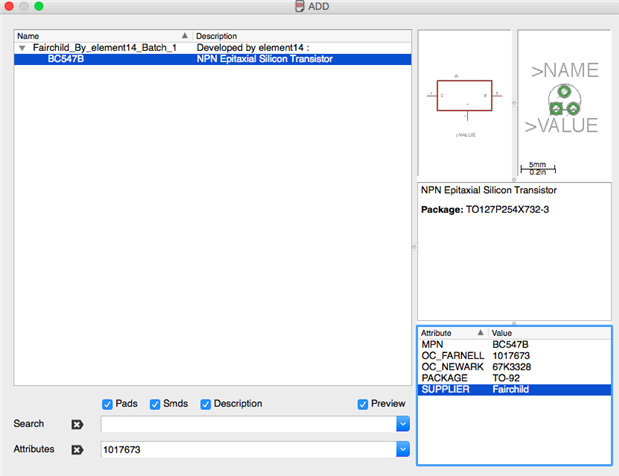

I'm trying to add some BC547B transistors which is TO-92 package. This transistor, and any other TO-92 package I purchase from element 14 has the pins single in line (SIL).
However, seems all the transistors in the Eagle PCB libraries has a footprint of the older triangular layout of pins.
Being new to Eagle PCB I have no idea how to fix this. Trying to select any other PNP TO-92 transistors does not help as they all have the same footprint.
Can you please point me in the right direction (or library) I can use.

    Yes, I did start with a schematic.
    I read through the documentation. Other than creating or modifying the library files, I don't see how to fix this.
    I downloaded the latest Fairchild Library and searched for the component using the element14 product code (1017673) to make I get the correct device. Still, the footprint does not match that of the datasheet or the actual device.

    0 shabaz over 11 years ago in reply to Former Member
    Hi jengel,
    You can edit the library yourself if you like, and then select Library->Update in the schematic view to perform the update on all such parts in your schematic (and then manually correct any traces you may have already laid out in the PCB view).
    However, I think maybe PCB assembly/production may have forming machines for transistors? If this is for a personal project, the pins will be extremely close together, so perhaps it is better to use the existing footprint, and manually form the wires to fit?
    Anyway, you can edit the library if this is what you really want to do (but better to create your own library for custom parts like this). This is described in the EAGLE manual.

    0 Former Member over 11 years ago in reply to shabaz
    Thank you shabaz for the reply.
    It would seem I'll have to go down the modified library path.
    Luckily I don't have to deal with forming machines. I am surprised though at how so many transistors can have the wrong footprint. I would have thought an application so popular (and expensive) would cater for the most common footprint.
    the most common footprint. s
    I feel this straight leg (low cost) TO92 variant was never intended to
    be inserted without forming the legs.
    Have look at the dimensions
    http://www.onsemi.com/pub_link/Collateral/BC546-D.PDF
    Consider how small the lands will be once the hole size and clearance
    between pads is considered.
    HTH
    Warren
