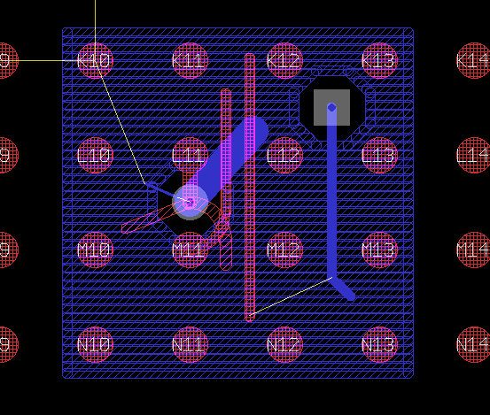

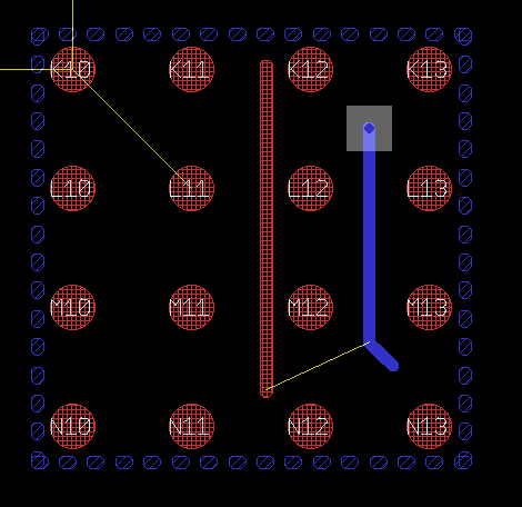

I have a .BRD with named wires and polygons, but when I go to RIPUP; it misses ripping up one of the wires, and when I RIPUP @;, it rips up the fillings, but not the wires/contours.  Am I misinterpreting what the command line is to do when typed or in a .SCR?  I need the functionality working in a ULP whose purpose is to partially rebuild the wires and polygons on a board.after an errant ULP trashed it.  I did see something out here regarding problems with RIPUP in 7.2, so I went to 7.3 to see if it was fixed.

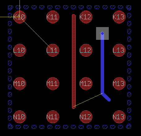

    I encountered the difficulty using 7.2.0 64 bit on Windows Ultimate up to date SP1 with 8GB memory, and when I saw reports of ripup problems on 7.2, I tried on 7.3.0 64bit.
    Sorry about the contour nomenclature.  I’m not sure about the correct term for the wires I draw as part of a polygon, but that is what I am referring to.  I need to be able to ripup all polygons on the board using a .scr and the documentation led me to believe it is the RIPUP @; command.  Please correct me if I’m mistaken.
    The ripup @; command is ripping up the fill and contour wires, as shown in the original, ripup; and ripup @; sequence attached, but not the polygon wires I've created the polygon with.
    In the example 6-layer board diagram, the BTEST signal is associated with the round via (between BGA pads) and traces that appear to be attached or airwired. The CTEST signal is associated with the M11 pad and visibly attached trace.  The ATEST signal is associated with the square via, attached trace, and other layer trace that has an airwire connecting.  The surrounding polygon on layer 2 (diagonal blue) has been assigned the GND signal and I’ve done a ratsnest.  All relevant layers are being displayed. Layer 1: pads/hash red, Layer 3 the diagonal red stripes, Layers 14&15 not used in the example, and layer 16 the solid blue.  The vias are grey.
    The original image is as described above
    The 2nd ripup image is after typing ripup;
    The 3rd ripup@ image is after typing ripup @; (no visible change and a subsequent ratsnest refills the horizontal fill wires)
    Perhaps you or someone can let me know:
    1. Why the square via and 2 associated wires were not ripped up in the ripup image, and
    2. Why the polygon I put down was not ripped up with the ripup @; command
      1. And if the ripup@; command is not supposed to ripup all polygons, is there a command that does so?

    From the first few lines in HELP > RIPUP
    Changes routed wires and vias into airwires.
    Changes the display of polygons to "outlines".
    So to delete a polygon outline you need to use delete.
    Checkout HELP >DELETE . To delete in one click you need to hold down the
    shift key.
    in a script you need to find the locations of the drawn wires and DELETE(Sx
    y)
    See HELP > Command Syntax > Coordinates
    The above also explains the wires that did not ripup in your images.
    The wires are not routed. They are named wires that do not have a
    contact-ref. When ripup occurs the result should reduce to an air wire. An
    air wire cannot cannot exist following a ripup; if there are not 2
    remaining points for it to connect between and the remaining points can
    only be pads or SMDs (ie contact-referrences). I suspect there are no pads
    with a signal name that matches those wires/via.
    HTH
    Warren

    I experimented a bit and found that wire ripup took place as soon as a plain wire had one connected SMD pad and must have been, thus, considered then routed.  Ripup @ seems to do nothing other than remove the polygon pour shown on screen.
    The HELP piece in the Editor Commands/RIPUP that I was reading and still find muddles things is : “The RIPUP command changes routed wires (tracks) into airwires.  That can be done for:…all polygons (RIPUP@;)...”. It probably should be restricted/reworded a bit.
    Can the perimeter wires of a polygon be[come] routed?
