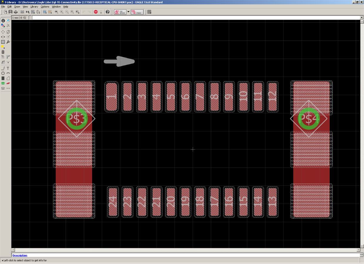

Hello Experts,
I have a package in my library that has a polygon that sits on top of a pad labeled P$3 (second attached picture with red pads). This pad is not connected to any pin in the device, because its purpose is to hold the part physically attached to the board.

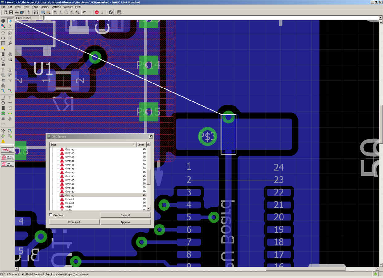

When I run the autorouter, it places the wires on top of the polygon that surrounds the pad and shorts them.
On the other hand, the DRC recognises that this is wrong and marks it accordingly (first attached picture with blue copper).

On this picture you can see a blue vertical wire that runs from the bottom to the top to a via, across the part's polygon. The wire was created by the autorouter.

    I don't use  the newer versions or the autorouter but putting a t or b
    restrict outline around the permiter of the pad should prevent the track
    crossing.
    Paul R.
