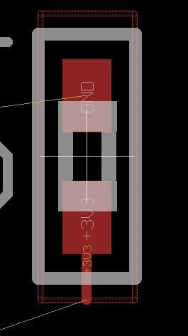

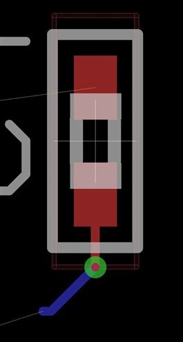

Routing:
Previously, when I was routing a trace, I would click the center mouse button and select the new layer. Eagle would then insert the via and then switch to the selected layer. I would then route on the layer I had just selected. Perfect. To me this is very intuitive.
Now, I click the center mouse button, I select my desired layer, and it forces me to route on the same layer I was on. It does not sink the via until after I've dragged the trace over pads that are for different signals. This, in my opinion, makes the routing tool incredibly difficult to use. We may be pushing Eagle to its limits with some of our designs. I often have to get around several obstacles and I don't know that I want to switch layers until I am stuck. Then I have to either group all the traces and change the layers, or they have to be swapped one by one.
I visited their support site, and I was unable to identify whether I could change this functionality back (you cannot). I was unable to find any "support" other than questions about subscriptions. I spent an hour looking for any way to change such a simple setting. I even contacted support, but when I asked if it was possible to change that setting I got, "So you are wanting to leave feedback?" No, I want to be able to use one of the most fundamental parts of a PCB design program the way I had been the past four years.

    4) press the middle mouse button - > select layer -> via is placed at current trace end and layer is switched
    Why does there need to be TWO additional steps? 4a and 4b are unnecessary mouse clicks in my opinion. I suggest giving the user the option to determine how that works. Especially considering the system was completely changed. It could be just like the different wire bend styles. When the middle mouse button is pressed and the new layer is selected:
    Option a) The via is sunk immediately, and routing begins on a new layer. (Legacy Eagle routing operation)
    Option b) The via is carried until an additional left mouse click has been made. The via is then formed where that mouse click occurs. (Eagle 8 routing operation)
    I guess my questions to you are:
    1) Do you feel there was any real improvement made in changing the routing engine?
    Hi Adam,
    I think so. Being able to backspace segments(hit the backspace key and
    you undo the previously laid segment) has been very useful for me. The
    idea behind the extra click is that you can determine on the fly where
    exactly you want the via to be, without having to commit to the end of
    the last segment you placed. It may seem like an extra click now but
    once push and shove comes into the picture(some time this year), you'll
    see that it beneficial to be able to carry the via around as you
    determine the best way to layout your signal. Keep in mind that now you
    can switch layers by using the spacebar and shift+spacebar keys which I
    find to be faster than the middle mouse click.

  • geralds
    geralds over 9 years ago in reply to rick_b
    I think there is a fault in the software too.
    Bouncing, ok, but this was not my argument.
    I meant switching from one layer to the other - if - the wire was stopped
    AND i like routing again i must go a step of grid and then i can change the layer.
    I created a small video you can see what i mean.
    Please open this video with the Mozilla Firefox browser.
    With the old version i can start routing directly after changing the layer.
    Yes bouncing the  mouse contact also sleeping fingers can stop routing.
    But i like go forward at the place where i stopped, on the same layer or on an other layer.
    Best Regards,
    Gerald
