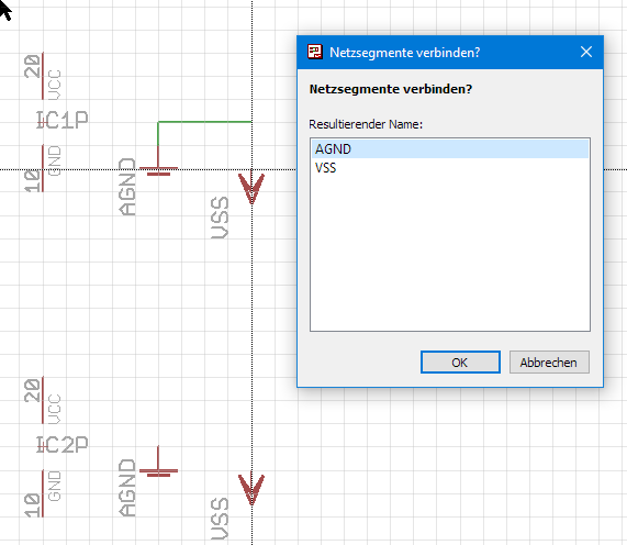

    Hi,
    aha, ok, that's easy i think.
    After that if you merges two segments together to one segment, the menu
    will ask you, e.g.: "you are connecting two segments;;; the result name will: "...this name, or this name..";; is this ok?"" or similar.
    Well, that is easy for N$xx wires. -> just connect it and the suggested name N$xx appears.
    This will normally the latest wire number, or the first unused N$xx; e.g. N$1 ( or if N$1 is used, N$2 will come).
    Other think about is if you have power wires. Here you have priority usage of this wires.
    E.g.
    VSS -> GND => GND; GND -> VSS => VSS;
    // because you have supply pins on mostly components, you needs to check it manually.
    Here in this example: AGND (analogGND) or VSS; but GND (some other have VSS as GND) are power pins of the ICs.
    What i want to say: "The wire with that you're going, this wire likes merging to the other and this (other) will you get, or what you want, ... normally."
