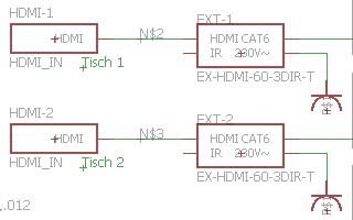

I draw with own parts and link this with net together.
Now I want to write a CSV File with this information.
I already have all information in the file, but have problem with the "nets"
A net:
Has a source and target (or more)
now I want to loop over all nets:
SCH.sheets(SH)
SH.nets(N)
But now I use segments and then pinrefs.
But I need a loop, for each net which give me the source and target of the net.
Example:
Have to loop over the nets (N$2 and then N$3):
N$2 = source HDMI-1, target EXT-1
N$3 = source HDMI-2, target EXT-2
How can I reach this goal?
Thank you!

    I use Eagle not for electronic parts. I draw audio/video/multimedia components and their connections. I also print the labels for this parts (Matrix, Loudspeaker, Amplifier, HDMI Extender, ...) with ulp export
    I draw each pyhsical component (Beamer, Loudspeaker, Matrix, ...) with their inputs and outputs.
    Normaly I have only 1-to-1 connections, like:
    Ethernet
    RS232
    RS485
    Loudspeaker cable
    HDMI cable
    So 1-to-many I don´t use.
    For me, a net ist as example a HDMI cable ... this has a one start point and one end point.
    So each net has:
    start point (source) --------- net name ------------ end point (destination)
    I set up each pin:
    in
    out
    io
    pwr
    I loop now over all nets and for each net I loop again over all nets:
    In the second loop I check for:
    If same netname
    If source pin is IO or OUT
    If part name is not equal (because to remove dulpicates)
    SCH.sheets(SH)
    SH.nets(N)
    N.segments(SEG)
    SEG.pinrefs(P)
    cablename = N.name;
    SH.nets(N1)
    N1.segments(SEG1)
    SEG1.pinrefs(P1)
    if(N.name == N1.name && (P.pin.direction == PIN_DIRECTION_OUT || P.pin.direction == PIN_DIRECTION_IO) && (P.part.name != P1.part.name)){
    from = P.part.name + " (" + P.part.value + ")";
    to = P1.part.name + " (" + P1.part.value + ")";
    cabletyp = N.class.name;
    This works in the first version :-)
