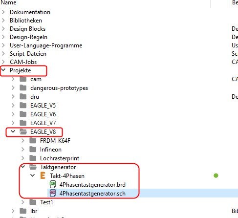

    Hi,
    1) entry in the panel - options - folders -> the location of your project folder
    2) in the panel you can create your folder for your project (it will saved in your project folder automatically)

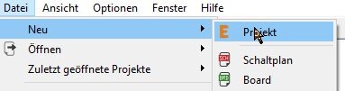

    3) open in the menu - create a new project. -> the green lamp lit on
    create a new sch file - your sch will saved in your project folder automatically

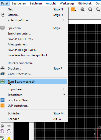

    4) in the schematic you have a menu - "change to board"
    -->> click on the item "change to board" - then you will asked "migrate the devices from schematic  to board" ... or similar..
    >>> important - press in the menu "save all" then you project will now created with your name.
    ok, this project is just empty as well now you can create your schematic and all devices will also inserted into the board automatically.

  • matelot
    matelot over 8 years ago
    Thank you for the reply.
    I am assuming that a project is just a directory where all the files
    associated with one job (or project) are kept?
    I have made directories for all my projects and moved the sch files into
    them (I also moved all the temp files with the suffix .s#1 .s#2 etc.
    The control panel only shows the .sch and not all the temp files (I have no
    board in that project but I suspect it would show a .brd if I did). (I made
    a new .brd in my test project and it did.)
    I now see that if I click on the button after the project and turn it green
    it puts the sch in that project, is this correct? it did with .brd .
    My list in the control panel still shows as
    eagle
        test             .    empty project
            test.sch
    Why does it still say 'empty project'?
    I have just answered my own question, I closed the control panel and
    reopened it and the 'empty project' has gone.
    Thank you Geralds that answers my question perfectly.
