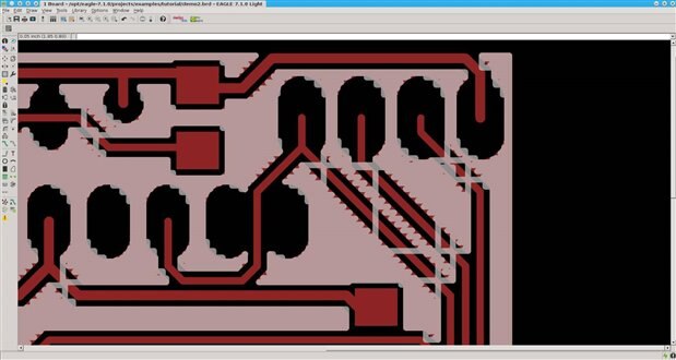

I'm wondering if following is possible. I need to have a ratsnets being made based on top layer, but the polygon itself needs to be stored in a different layer. I need to automate process with cam and I need to have it stored under different layer to apply different settings to the job. But the ratsnets needs to be decided on the top layer.

    Hi Lorenz, Thank you very much,  it's almost doing it perfectly.
    It's bit rough around the edges, which probably I could live with, or maybe is there a way to make the line much thiner?
    But there is an issue and it's creating some artifacts where it is crossing traces (see attached picture), this layer will be fed into cam job to do isolation routing on a CNC so the artifacts would damage traces, while I need to remove only copper around the traces. The isolation routing is heavily time consuming, while there is an easier way to do it on the whole PCB, with a polygon fill / ratsnest I would have the freedom to select only desired parts where I really need to do it.
    When I was doing chemical process, everything worked fine I worked with output which described the traces which need to stay.
    While with mechanical CNC routing process I do the oposite, I concentrate not on traces, but on their outlines, because that needs to be removed, So the result looks like I would have polyfil on whole board enable. Which is problem if there is for example USB connector on a PCB or something where polyfill is undesired. And the polygon fill can be done in flatcam but it needs to know all the places to avoid already in the polygon, if I would leave the polygon there without conflict avoidance then the router would mill away whole polygon. So this way it will turn into an outline which then can be safely filled in flatcam into gcode which will mill away all the copper safely without damaging the traces.
    With chemical process the polyfill added more copper on the result, while now with the polyfil I want to remove copper in the mechanical process, because without anything the results look like this:
    https://i.ytimg.com/vi/g7A0pnUetRY/maxresdefault.jpg
    It just mills around the outlines of traces so it isolates the traces from each other and leaving large chunks of copper present.
    Here is the artifact of the script:
    You think it could be fixed?  Thank you very much again, with this I could have the process automated, while now I waste lot of time doing it by hand on every single export image
    Best regards,
    Anton

    change the line
    |  string s, cmd = "change layer 100;";
    into
    |  string s, cmd = "change layer 100; set wire_bend 2;";
    that should get rid of the rough edges on sloping lines. I didn't see
    this here because I had set the wire_bend beforehand.
    happy new year
    Lorenz

    This is excellent, I made a handful of ULP scripts many years ago, but they were not close to your skill. How did you learn to be so brilliant at it? image
    The wire_bend fixed both issues the outline stroke was there to smooth the edges, but without bend it was forced to use perpendicular lines wich caused the second issue. If you will be in Dublin at some point, give me shout, I will take you for a lunch/dinner or few pints (whatever you prefer).
    Too bad this is not directly supported in the eagle (collisions referencing different layer than the original object), it would allow some interesting scripting in CAM. The ULP it looks bit heavy (maybe because the lines are hardcoded), but they are static so they can move around layers, which is excellent. I was hoping there would be bundled feature, or if not a brute force ULP script which will mimic the results, which this is exactly that image This will save me so much time, in practice I will use it on very small portions on PCB, but it was human labor heavy to create the polygons for every iteration of the board.
    I added the cleaning of the 100 layer so it's safe to re-run the script multiple times when the design changes and I will need to refresh the layer 100.
