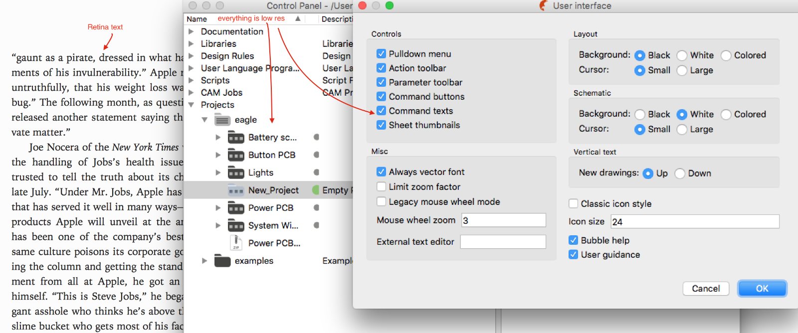

Dear Internet and CadSoft,
I have been waiting for then new Eagle to come out with HiDPi support for Mac OS,
I was super excited to see that you now support hi-res display but only after installing I was  more than disappointed:
Text, writing and actual editor doesn't seem to be in hi res mode, at all I can do is to make icons larger but this doesn't translate to clear and crisp picture when designing PCB's.
Please could you let me know if this is only a bug? Or a problem with my installation
I have selected larger icons and vector text relaunched eagle, and its still look like a program from windows '95 common this is 2016 and i would really like my fonts, lines and shape to be nice and crisp....
Please let me know you you are planning to support retina displays in the near future?

    Hi Eryk,
    I don't think it's a bug, I think something got lost in translation to
    the devs. At the moment we don't have a Retina display on hand and it's
    likely the devs thought that it was enough to have scalable icons.
    Thanks to reports like yours though, we have a spanking new Retina
    display on the way and this should be cleared up shortly.
    Sorry about the inconvenience.
    Best Regards,
    Jorge Garcia

    I guess the gfx artifacts are not just related to the "[apple] retina"
    displays. Any high res normal dpi mode has issues, like my 4k 40"
    running in normal DPI. Look at the B's in particular, but also the
    captital S has issues. (Running win10)

    As soon as the texts are upscaled for better readability on the high res
    displayes there is something going wrong. We hope to have a solution
    probably with the next beta version.

    Morten Leikvoll wrote on Thu, 14 January 2016 12:43
    displays. Any high res normal dpi mode has issues, like my 4k 40" running
    in normal DPI. Look at the B's in particular, but also the captital S has
    issues (Running win10)
    Yep they have a lot to do to get their HiDPI support up to scratch. It
    seems they thought just scaling icons was enough....
    It's vaguely more useful a feature in windows but makes zero difference in
    OSX because the OS detects Eagle as non retina compliant and tells it a
    lower resolution.... I actually have it working in a Windows 10 VM, set to
    the native Retina resolution, scaled the icons in Eagle and scaled the
    fonts in Windows and I'm almost getting the benefits of the Retina display,
    but it's not quite right still.... And on Windows so not where I want all
    my work....
    They also need to do something with their font rendering as they seem to
    not be doing any anti-aliasing on text so even on a large display with a
    reasonable font size the fonts are not smooth and they change appearance as
    the zoom level changes.
    Lots for them to work on.... I really hope we don't have to wait for v8 or
    beyond for this to be fixed....
